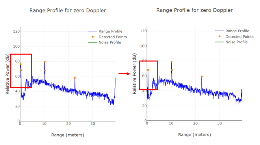

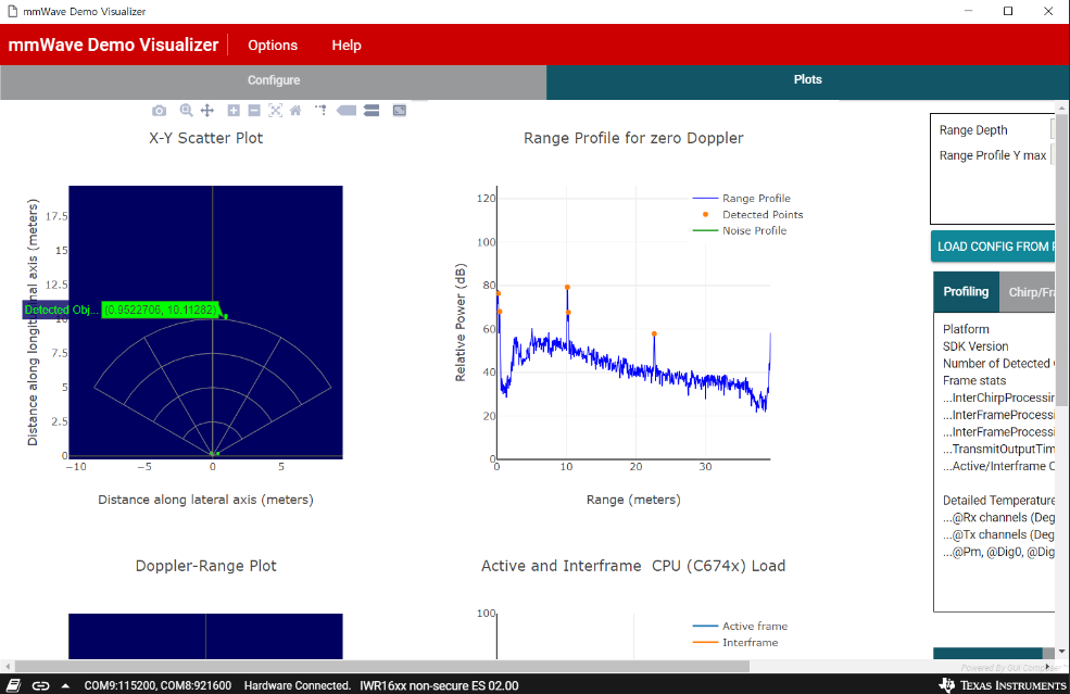

In the above test process, False detection(ghost) appeared. There is only one target at 10m in front of the device
The antenna coupling signature was removed through the calibDcRangeSig command, but the result was as follows.
How can I get rid of this false detections?

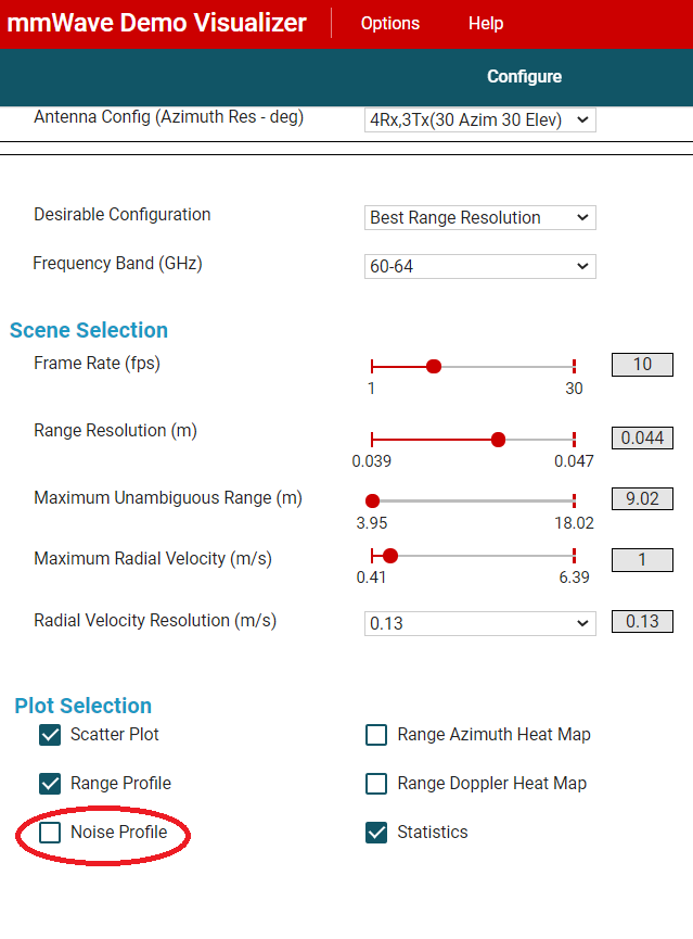

  • Hi, there:
    1) Regarding SNR check, I would recommend you to enable noise profile in the plot selection (see the figure below), and then check the signal and noise level.   The signal profile is calculated from zero-doppler and noise profile is calculated from high Doppler (both are with all the antenna non-coherently combined).

  • Thank you for reply,
    1) Ok, I'll test it later.
    2) In this case, there is only one object at 10m in front of the device.
    However ghosts appear around DC and 22m position. I want to remove ghosts at both positions.

  • HI,
    For the false detection around DC, I would suggest to skip the first several range bins in the CFAR detection to avoid the detection.  Regarding the detection at 22m, you will have to do more investigation.  Did you have any floor/ceiling/wall reflection, how you can be so sure that you only have 10m target?  Can you move the 10m target and see whether it affects the 22m target to check whether it is some multipath reflection or inter-modulation (it is very unlikely) related to the 10m?
    1) For the false detection around DC, I used command(calibDcRangeSig -1 1 -5 8 256), but they have not completely removed.
    How can I skip the first several range bins in the CFAR detection?
    Do I need to change the code or parameter of calibDcRangeSig command?
