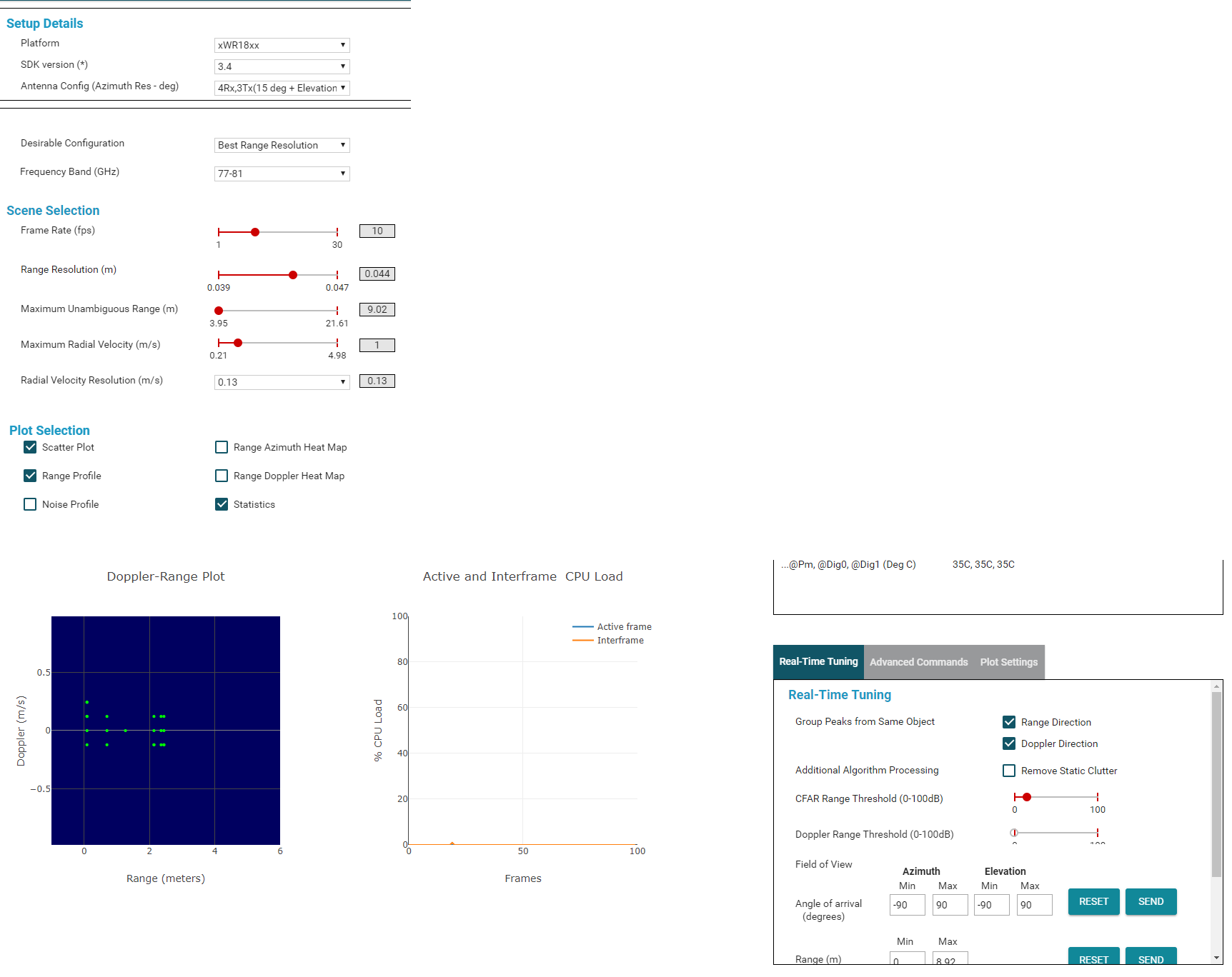

When CFAR thresholdScale in the Doppler direction is set to 0 in the OOB Demo of the IWR1843 BOOST board,
It looks like peak grouping in the Doppler direction is not working.

Questions:
1. I look at the source code for SDK 3.4.0.3 and understand that when thresholdScale = 0, the CFAR process in the Doppler direction is skipped.
Is this understanding correct?
mmwave_sdk_03_04_00_03/packages/ti/datapath/dpc/dpu/cfarcaproc/src/cfarcaprocdsp.c
line 1580-1595
2. If I set the CFAR threshold Scale in the Doppler direction to 0, does peak grouping in the Doppler direction not work?
3. If I set the CFAR threshold Scale in the Doppler direction to 0, how do I get the peak grouping in the Doppler direction to work?
