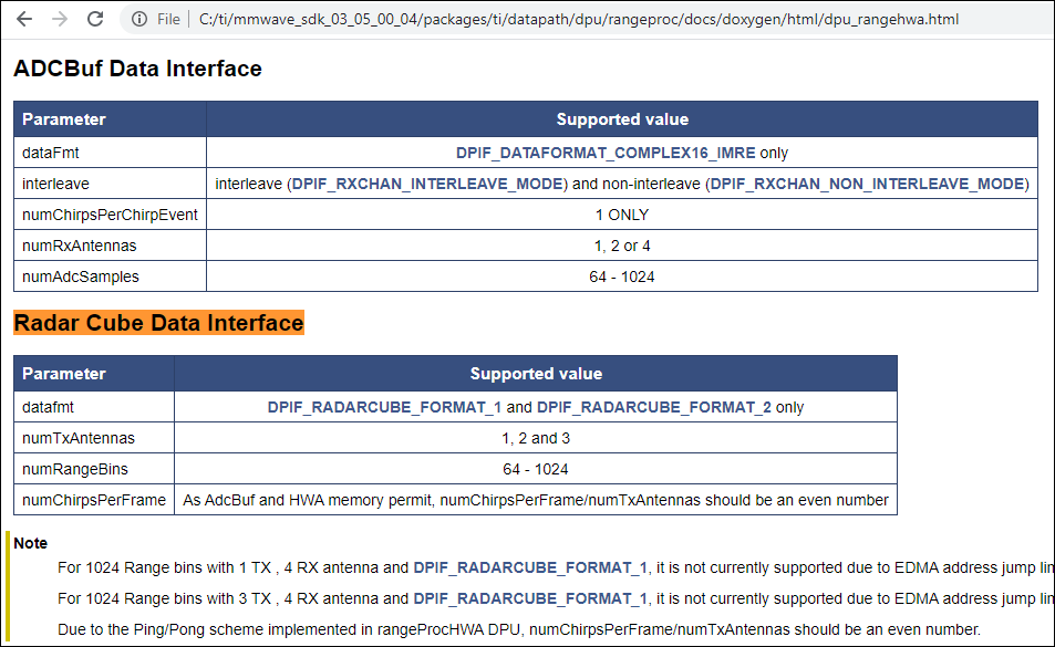

    The Out of box demo requires the number of loops (i.e. repetitions of the chirp in the frame) to be at least 4 as mentioned in the SDK user guide. You can change it to a minimum of two chirps (but not 1) by changing the Doppler DPU Window type as shown in the file below:
    You'll need to replace the highlighted constant with the MMWAVELIB_WIN_RECT.

  • Hi Lim,
    Yes, as noted in the RangeHWA DPU HTML documentation, (number of chirps per frame/number of TX antennas) has to be an even number so the minimum number of chirp loops supported is 2.
