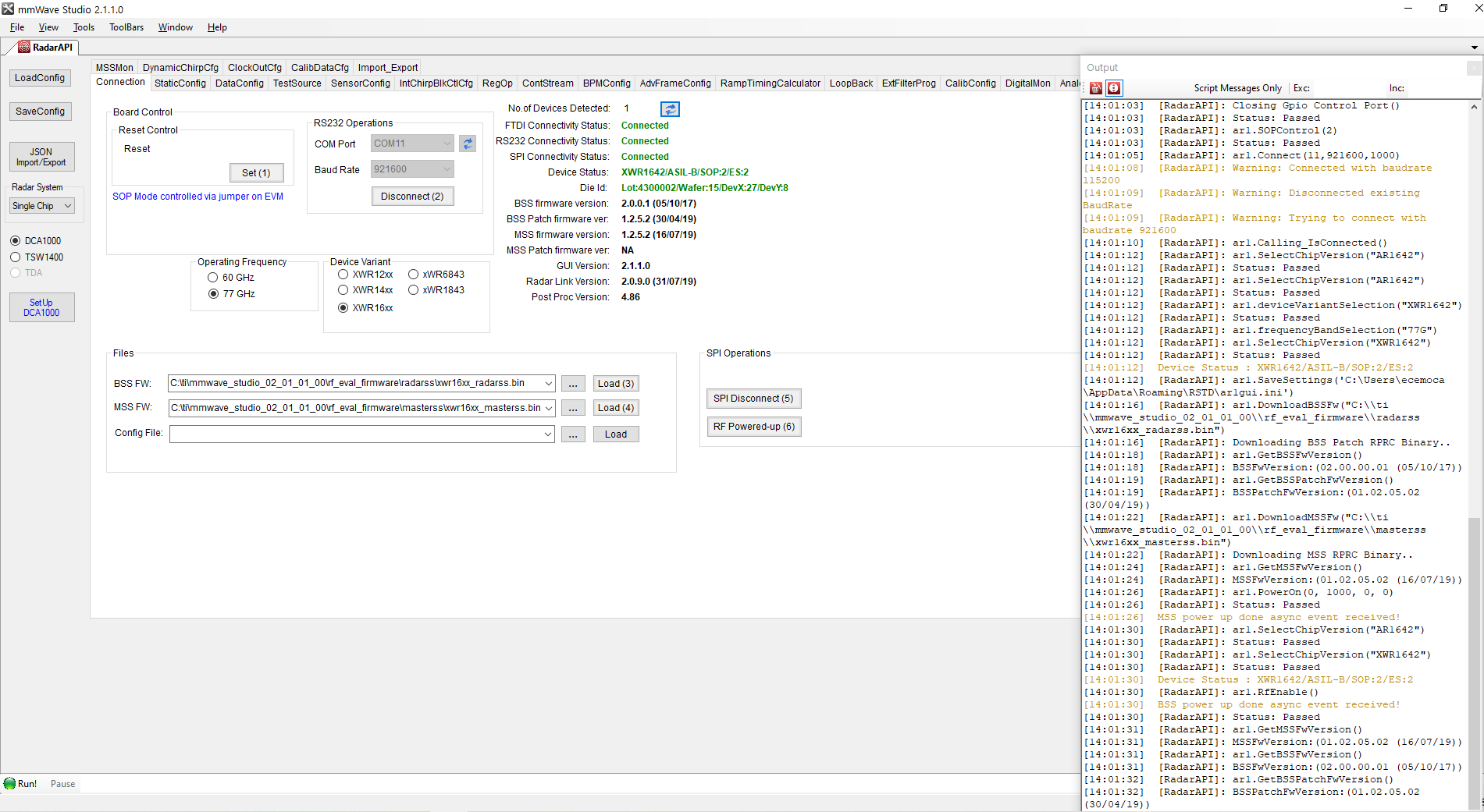

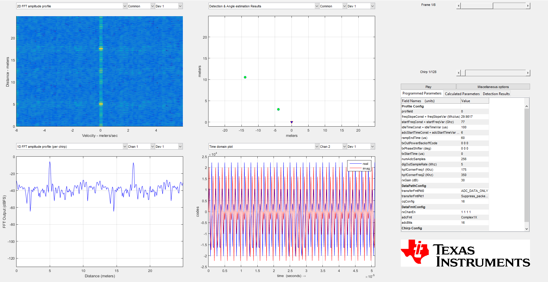

  • Hi, Kyle, thanks for your reply.
    I tried using the DataCaptureDemo_xWR.lua script. It works well and can generate a reasonable correct result as shown below. And I find the main difference between the demo and my setting is the firmware and the testsource. Does it mean the problem come from the firmware in C:\ti\mmwave_studio_02_01_01_00\rf_eval_firmware
    Xi Cheng

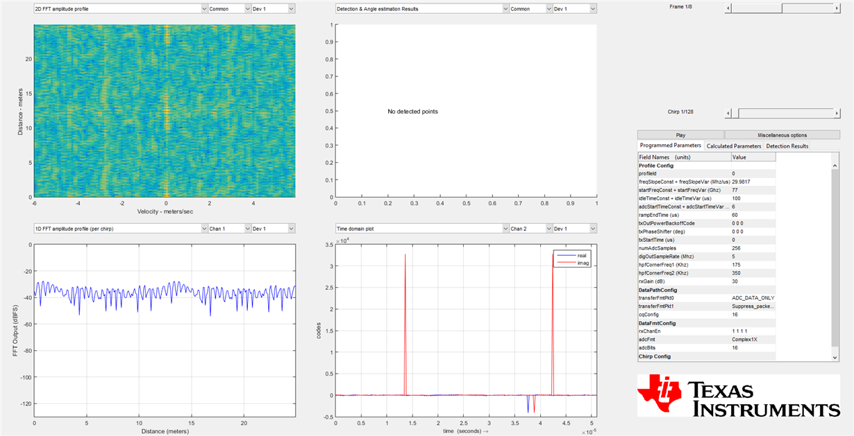

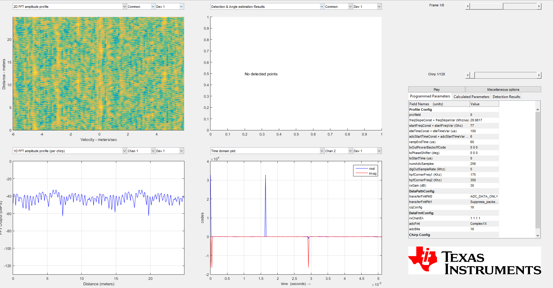

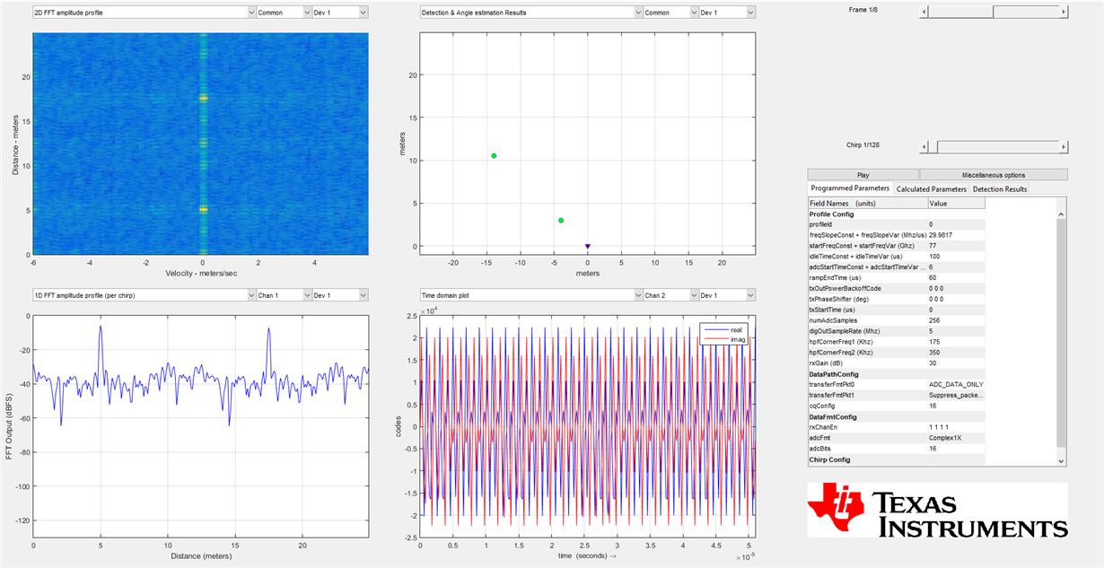

    I try to disable the testsource, and I found that the results become error once the testsource is disabled, even with the DataCaptureDemo_xWR.lua script.
    Running the DataCaptureDemo_xWR.lua script (the testsource is enabled as default)
    After running DataCaptureDemo_xWR.lua script, disable the testsource and run the data collection again. (I was sitting in front of the board)
    So it still can't capture the user in front of them.

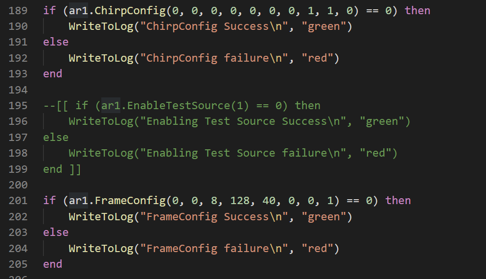

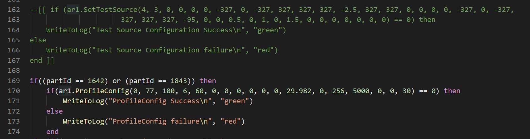

  • Xi,
    I would recommend removing the ar1.EnableTestSource(1) command from the capture demo script. Please make sure the script does have any Test Source references.
    Please also make sure the LP mode is set to the Low Power ADC. This is the only supported option on AWR1642.
    Feel free to upload a few images of your physical setup to assist in your debug.
    Kyle

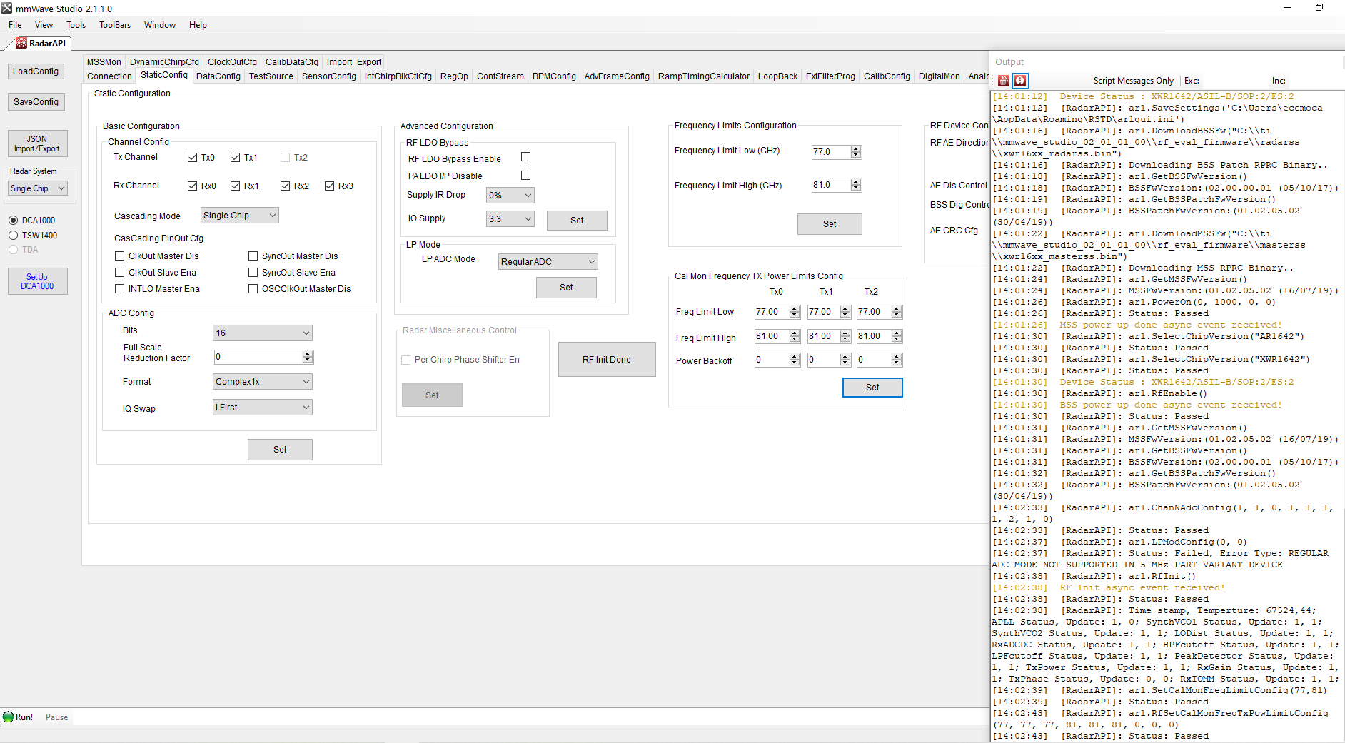

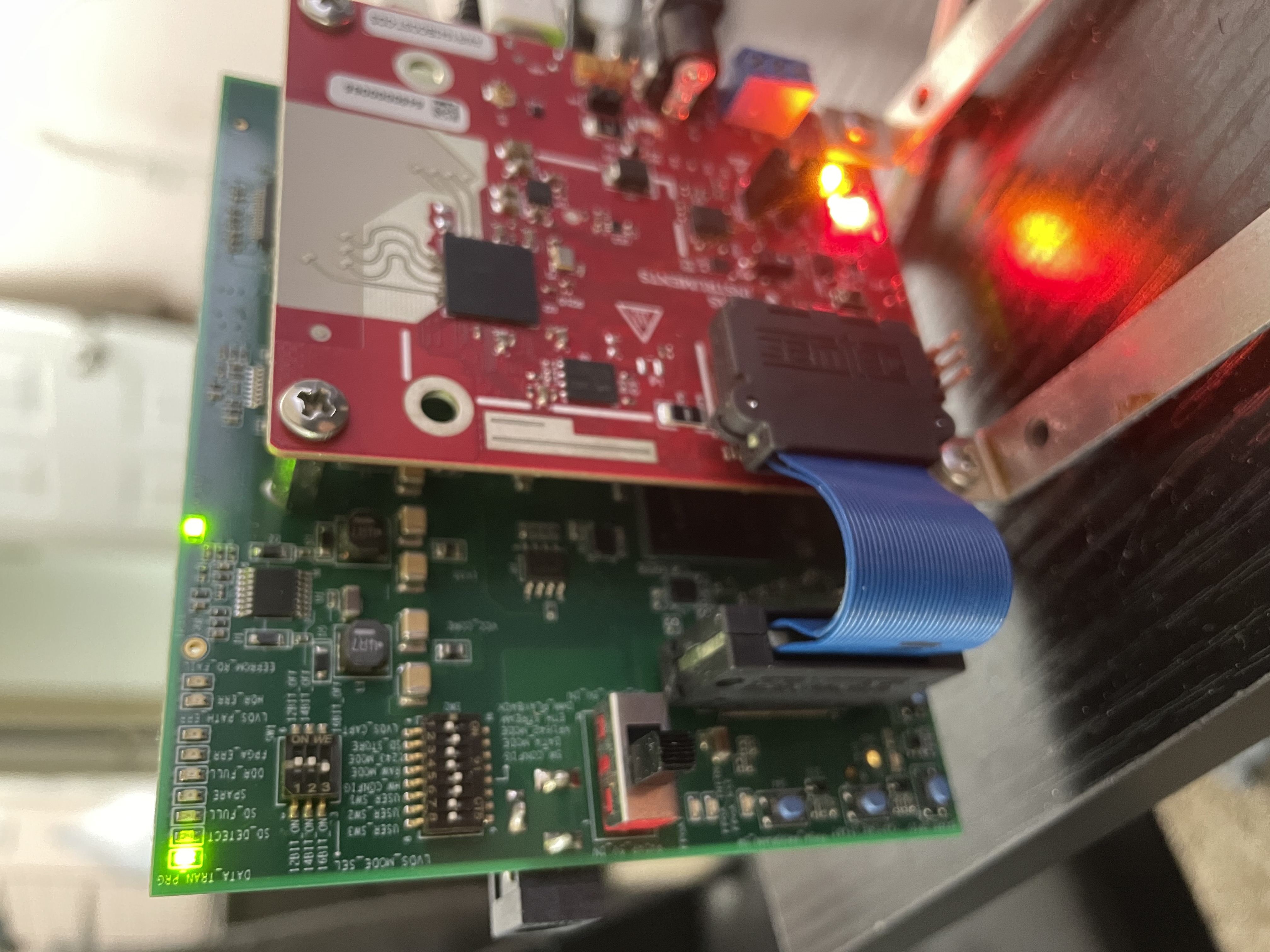

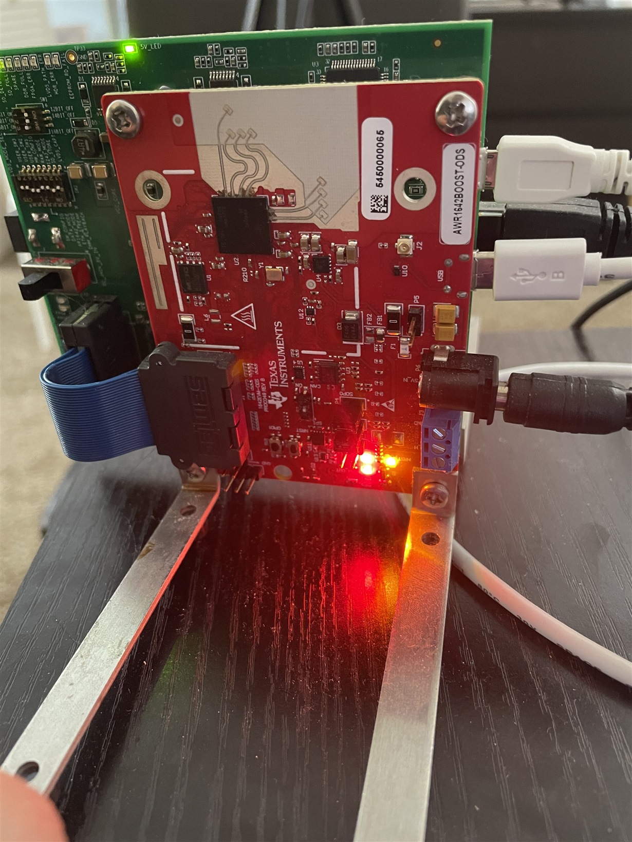

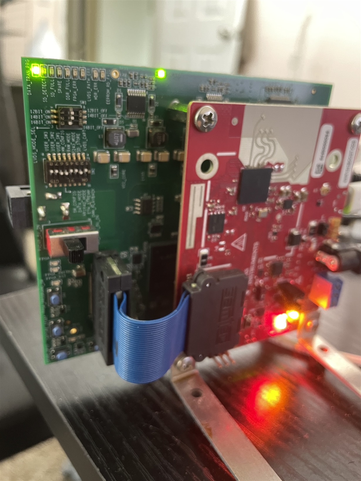

    I tried commenting out the command related to test source setting in DataCaptureDemo.lua.
    all the other part of the script is not changed. The LP mode is set to Low Power ADC mode by the script. And the data collected is still incorrect.
    And here are the physical set up of my device
    Xi Cheng
