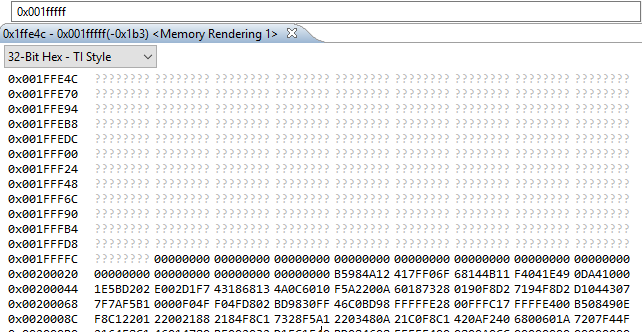

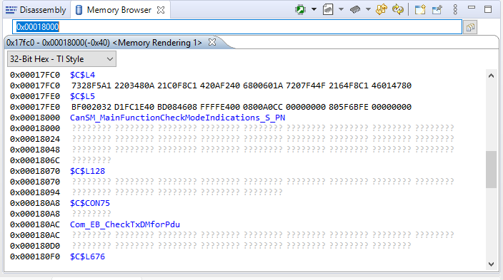

  8. We trigger a Soft Reset using the Mcu_PerformSoftSysReset() function present in Mcu_Platform.c file:
    1. (void)regWriteReadback(&toprcmREG->SOFTSYSRST, M_SEVEN, M_ZERO, resetVal);
  9. After we write this register the MSS_TCMA_RAM is not accessible (from-> 0x00018000 to -> 0x001FFFFF)
It seems that the registers are not correctly re-initialized. We need to perform some extra steps before we trigger the SoftReset?
Florin.
  • Hello

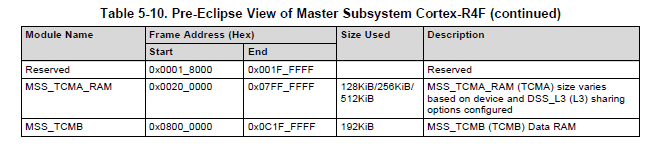

    The reset you are issuing is Warm reset and it will reinitiate the boot loader sequence  which will take the device to pre --> post eclispse routine.
    So you may have to reload the memory section to see the required mem space in that eclipsed region.
    Would you be able to help us understand the intent of the reset you are trying to issue.
    If you wish to only reset the R4F core then you may try the Cr4 reset which doesn't reload memories or go through the eclipse routine.

    We resolved our issue by only resetting the R4F core.
    Florin.
