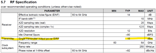

    I'm not sure, if I'm getting your correction on the transmit power. That's what it says in the datasheet
    Do you want to express the following connection: EIRP[dBm] = P_t[dBm or dBi?] + G[dBi], with G=5dBi and P_t the transmit power. Did I understand that correctly? Your text is confusing, you say transmit power is 15dBi and than suggest to use 10dBm as transmit power.
    Gain usually depends on the relative position from object to radar, so transmit power changes with the postion of the object relativ to the radar?
    And where do you get the 5dBi from?

  • HI, Anne:
    Yes, you are right, I am trying to say EIPR includes transmit power and transmit antenna gain, total of 15dBm.  Sorry for the confusing.  The TX power is usually in dBm and antenna gain is in dBi.   AOP antenna gain is listed around 5.2dBi at: http://dev.ti.com/tirex/explore/node?node=AGMzFzzFdFllMlyaWeXNlw__VLyFKFf__LATEST
    The one relative to the distance is the propagation loss, not the transmit antenna gain.
    Zigang

  • Hey Zigang,
    Yeah, I know that. It is in the datasheet.
    My last question refers to the values on the homepage. I try to ask it the other way round: Does the 12dBm transmit power, and the 5.2dBi gain refers to a single antenna or all antennas?
    Anne
  • HI, Anne:
    12dBm is the transmit power per antenna for non-AOP device, which is in the datasheet for general xwr6843 device.  5.2dB antenna gain refers to single TX antenna gain.
    Zigang
