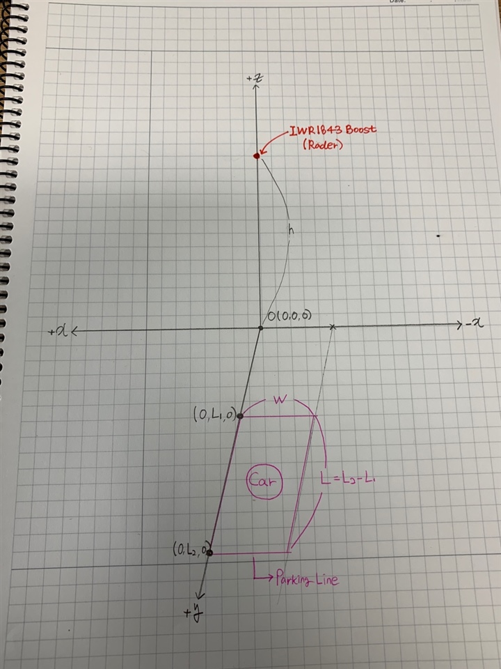

I want to check the cars in the parking lot in 3D mode with IWR1843 EVB and 18xx_traffic monitoring demo(Link: dev.ti.com/.../node
But, I don't know what to do with the relevant settings.
I think there are two set-up areas. One in the visualizer's GUI(in tm_visualizer.exe -> sensor information), the other in the traffic config file at labs -> traffic_monitoring -> 18xx_68xx_traffic_monitoring folder
I want to observe a parked or moving car in the parking line of the image below.
What is the difference between sensor information setting of visualizer's GUI and sensor position setting of traffic config file?
How should I set it up to perform this? Please tell me.

  • Hello, I'm sorry for the late.
    I am using traffic_monitoring demo of mmwave_industrial_toolbox_4_6_0.
    And I'd like to set up a radar at IWR1843 in the picture above, and watch the car enter and exit the parking space.
    I understand that we need to set up two areas for this.
    One is Setup in the picture below, and the rest is a 3D cfg file.
    The areas I am interested in are the sensor information area of GUI SETUP and the sensor position area of the 3D cfg file.
    How do I set it up to determine whether a vehicle is in or out of the parking space in the picture I posted in the first question?
    please regards, thank you.
