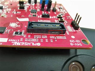

I used the mmWave studio 03.00.00.14 to collect the raw data of AWR2243+DCA1000 but met with the error:  Error : The number of files captured is zero!   Here is the log information:

[16:20:27] [RadarAPI]: No of files Captured: 0, Total no of frames for each device : 8
[16:20:27] Error : The number of files captured is zero!
[16:20:37]
[16:20:37] ***Script completed successfully.***

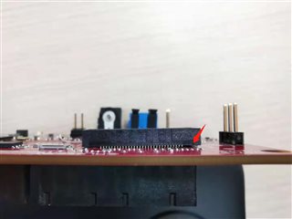

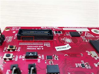

Here is the connection picture:
The ethernet connection of DCA1000 and computer is OK. By the way, how to download the previous version of mmWave studio-2G?
