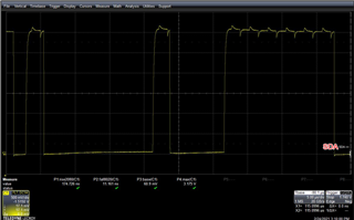

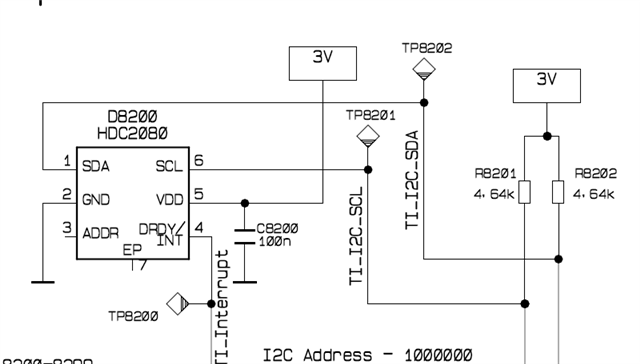

We are using HDC2080 sensor in one of our design and we have observed misbehaviour of the sensor. The sensor reads 100% humidity continuously and recovers only after a power reset. And this is observed soon after power on of the device and also during mid of testing.
Below are other details.
1) The actual humidity was around 16%, where as the sensor read 100%
2) Also temperature offset of 2-3 degrees observed.(Temperature reading was 2 degrees higher than expected)
3)After the power reset of the board,the sensor started reading the optimum value of humidity and temperature.
4) This was observed in 2 of our products. One was kept in temperature chamber at 40 degrees and one was in room temperature
During this phase of misbehaviour we have conducted a few experiments and captured few observations. The details are explained below
1) Kept the PCB in most ventilated place.
2) Place the finger on the sensor for some time
3) Blew hot air on the sensor area. After this process only temperature reading showed higher value but the humidity was still 100%

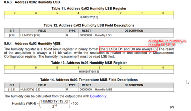

4) We are using I2C as communication interface, so we analysed the communication data as well. We see that,according to data sheet, the values in the 2 LSBs D0 and D1 needs to be 0 in humidity register.This is not met
5) Finally we did a power reset, the sensor started working normally.

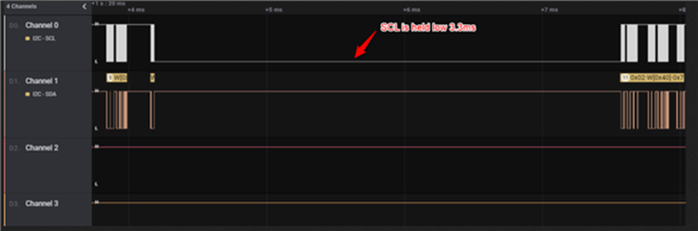

    Regarding the SCL being held low, what else is in your system? The HDC2080 does not support clock stretching, so something else is holding the line low. Both the SCL and SDA lines should be high after sending the start conversion.
    Thanks for the screen captures - they are helpful!

    Thank you for your reply. As the sensor is in Auto measurement mode, the communication starts as it is mentioned in the above image.

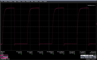

    6)Below i have also attached SCL and SDA signal details

    Also, it does look like there is some clock activity happening on the SDA line capture you sent over. I don't think that is causing a problem for you here, but you might want to look into tracking that down in your layout and getting rid of it. Might be radiated, might be conducted, hard to say - looks like you are running the I2C bus at almost 400kHz (from SCL capture), and those little spikes in SDA capture look to be in that same range.
