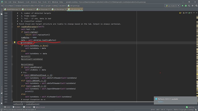

  • hello,
    To print the uart data i opened  oob_parser program of visualizer from the lab and added print statement in readandparseuart() function. It directly prints the uart data in hex format in the terminal. i havent used any convertors for the data.
    This is the uart data in terminal.
    So this is the data captured from the terminal and i have mentioned the magic number and version from the data captured.
    Other hex values are not matching or i am not able to interpret those with the frame structure given in this document(user guide)

  • Hello Rohan,
    I think that print statement might be messing up the data. Please see the visualizer user guide for more options on saving the data. There are two flags at the top of OOB_parser.py, saveBinary and saveTextFile. If you enable one or both of these flags the visualizer will save the UART stream in a format that is easier to read and not modified for printing, as well as a csv file containing the parsed information. Please try using that to save the data.
