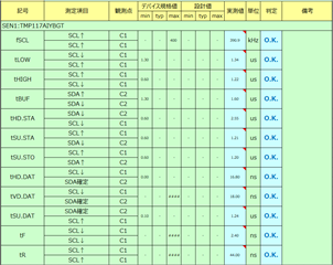

We are using tmp 117 to sample temperature data.
It reads data rightly, but sometimes it will read wired data like the capture below.
we did not change ambient temperature.

  • I could not provide the capture on oscilloscope for the time being. I'll upload it when it is ready.
    but our hardware engineer have had a test on Electrical characteristics and they are inline with datasheet.
    I will attach the test data.
    On software side, we use One-shot mode, and wait for 18ms for reading data after send a read request.
