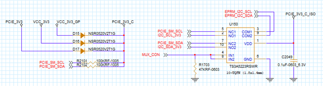

We're currently communicating with SMBUS and I2C via a MUX. Due to an I2C READ communication failure occurring through the MUX, we checked the MUX output and found that PIN 3 (CON1) SCL was not dropping low but was maintaining 2.9V. This appears to be the reason for the communication failure after 10 RETRY attempts.
The input PIN 2 (NO1) is dropping low (0V), and both the MUX's appearance and X-ray images confirmed no problems.
We checked the pin impedance of the MUX and found that PIN 8 (IN2) was 7.7 ohms. The PIN 1 (VDD) impedance was also 426 ohms.
However, when removing the MUX, the PIN 9 and PIN 10 pads fell off. This raises questions about the feasibility of the product's FA.

    No worries - thanks for updating. Are you able to probe the source of the SCL line and compare it to pin 3 on the mux? The mux is a passive mux, so should just be passing through the signal it sees. If you are seeing something abnormal, it's likely due to the source of that signal.
    If you need further help, I'd be happy to review your schematic.
    Katy

    Yes, I've already compared them. I've provided a more detailed explanation in the PPT.
    I checked the SCL input pin (PIN2) and the output pin (PIN3). PIN2 drops to 0V, but PIN3 only drops to 2.9V.

    You could please provide the schematic, voltage levels on each pins, and state of the mux (ie open/closed)? Could you also please elaborate on what voltages/currents/etc are used during the SSD tests? This will help me continue to debug.

    I've attached the MUX-related circuit diagram.
    Please check it.
    Jooeun
  • Hi Jooeun,
    No concerns from my end on the schematic. Not sure the details on the SSD tests, but depending on voltages, that might be the culprit.
    Katy
