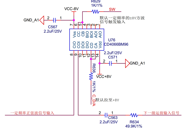

CD4066BM96 PIN9 output signal is abnormal. After replacing the previous batch of chips, the signal has returned to normal. Please help analyze the cause.
2. The following is the CD4066 input waveform and schematic diagram.

Hi Reed,
What does pin 9 output look like?
If I am understanding this properly, the "bad batch" was removed and replaced with a previous batch; Meaning no alterations, just a drop in replacement and the device worked properly?

Hi Reed,
I am currently looking into the LOT information on the two batches. In regards to the pictures for pin9 output, you are saying the image on the right is the expected output and the image on the left is the abnormal one?

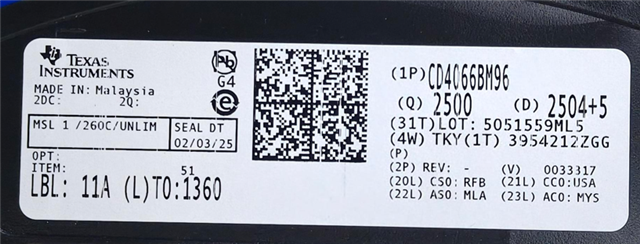

Hi Reed,
Do you happen to have the package with the LOT information, I have tried to find information on the devices from the picture but was not able to find the batch information?
Because you are saying this issue is just a batch error, since a previous batch does not have this issue.
Thank you,
Arya

Hi Reed,
I was able to find information on both batches. Was all the devices in the newer batch reel used to see if it all had the same output?

Hi Winnie,
I do have some questions regarding the schematic:
1. Is it possible to tie down all the floating I/O pins to prevent potential noise or unwanted behavior?
2. What is the intended function of these control pins with floating I/O connections? Are they being connected to VSS (-8V) elsewhere in the circuit?
3. How are these devices interfacing with the main board? I've noticed Pin 9 appears to simply output the input wave from Pin 8, which suggests the logic might be held high permanently rather than receiving the expected square wave input.
