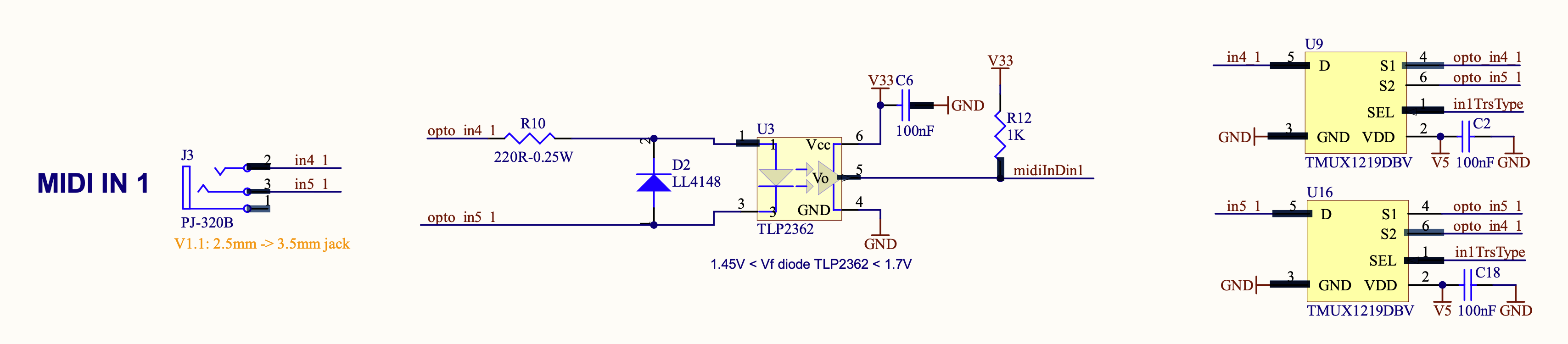

I'm using the TMUX1219 before an optocoupler, to handle polarity of the connected equipment.
My design is a MIDI input on TRS connector, polarity can be votage on the tip and signal on the ring, or the opposite.
My schematics are below :
TMUX switch selected by MCU GPIO.
TMUX powered from 5V
MIDI input is a current loop of about 10mA.
The jack connected to the TRS could be

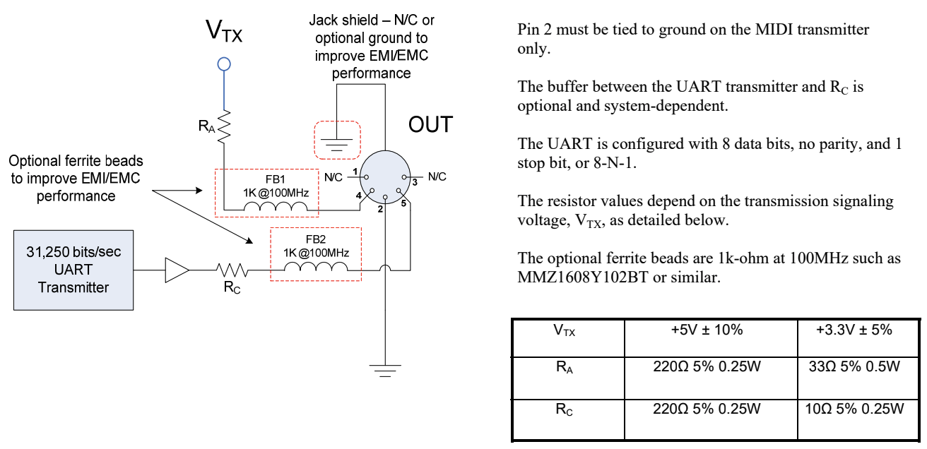

Type A :
5V -- Res 220R -- Tip
0V (when signal) -- Res 220R --> Ring
or
3.3V -- Res 33R -- Tip
0V (when signal) -- Res 10R --> Ring
Type B :
5V -- Res 220R -- Ring
0V (when signal) -- Res 220R --> Tip
or
3.3V -- Res 33R -- Ring
0V (when signal) -- Res 10R --> Tip
I'm observing the TMUX1219 destroyed depending on the connected equipment.
What could be the cause ?
I'm thinking about a floating ground issue, I mean there is no cmmon ground between the connected instrument and the TRS input, so the voltage applied to the TMUX1219 inputs could be out of specification ? For instance 6V ?
How to solve this issue ?
Do you thing using TVS diodes to clamp the TMUX inputs to VCC + 0.5V and GND - 0.5V could protect the IC ?
Thanks for any tip you can provide.
  • Responding to myself.
    The ground of the connected instrument is present on the jack sleeve.
    If I connect the ground of TMUX1219 to the jack sleeve, without connecting the ground to my board, that means the TMUX inputs will be constrained correctly since the MIDI output is always 5V or 3.3V (through the resistors mentioned above).
    But in that case, how to provide the 5V to supply the TMUX ?

  • My idea is to keep the ground separated on the sender and receiver, that is the original purpose of the optocoupler.
    Connecting the TMUX ground to the sender ground (isolated from the receiver ground) would solve the signal constrained between Vcc and Gnd of the TMUX, but how to power the TMUX with 5V if the grounds are separated ?
