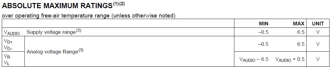

Could you please give us your advice as below ?
Q1. Absolute Maximum Ratings for D+/R and D-/L
Would you tell us the absolute maximum ratings for D+/R and D-/L as below ?
Which is correct although "-0.5V to 6.5V" and "Vaudio - 6.5V to Vaudio + 0.5V" are mentioned in the data sheet ?

  • Kato,
    Would you tell us the absolute maximum ratings for D+/R and D-/L as below ? Which is correct although "-0.5V to 6.5V" and "Vaudio - 6.5V to Vaudio + 0.5V" are mentioned in the is data sheet ?
    I understand there may be some confusion with the functional diagram.  There isn't a mechanical mechanism that phisically switches one path to another as depicted.  The funciton depicted is actually implemented with two different solid state switches that are either on or off.  One of these switches is optimised for passing USB data and the other optimised for audio signals.  The datasheet is correct that there are two different values since there are two switches inside optimised for different fucntions.

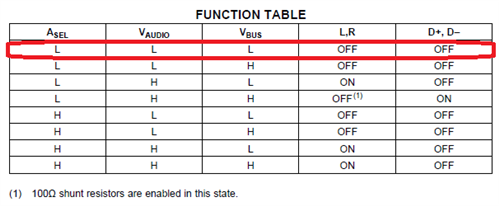

    Could you please give me your advice again since I would like to grasp the absolute maximum ratings and the input impedance for these pins of D+/R, D-/L, D+, D-, R and L in the following condition.
    <Condition>
    Asel   = 0V
    Vaudio = 0V
    Vbus   = 0V
    D+/R = ?V to ?V @ all power-off
    D-/L = ?V to ?V @ all power-off
    Q2. Input Impedance
    D+/R = ?ohm @ all power-off
    D-/L = ?ohm @ all power-off
    D+   = ?ohm @ all power-off
    D-   = ?ohm @ all power-off

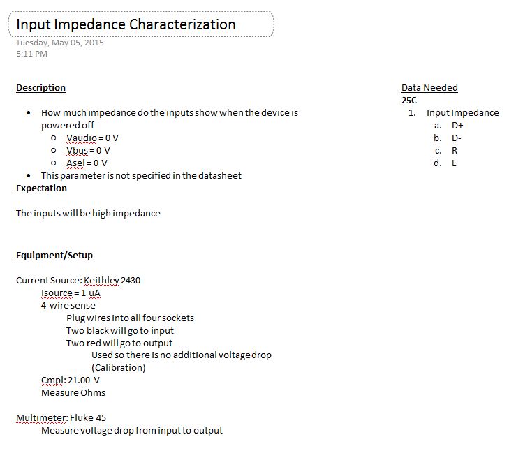

  • Kato,
    Ok, I will dublicate your test conditions in the lab and make the measurements.
    Adam

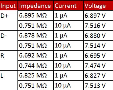

  • Kato,
    We have measured the signal path resistence when the TS5USBA224 is powered off.  This not official characterization but quick data we gathered to give you guidence.
    Results
    Adam

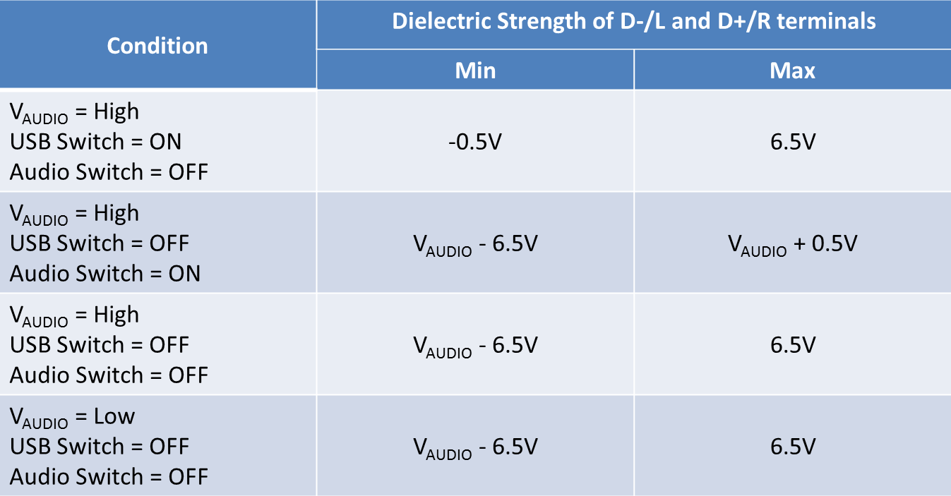

  • Hi Adam-san,
    Thank you for explaining in detail.
    Could you please give me your advice more concretely regarding the dielectric strength of D-/L and D+/R terminals ?
    I believe that the dielectric strength of D-/L and D+/R terminals is "Vaudio - 6.5V to 6.5V" since the usb switch state is "off" and the audio switch state is "off" when the device is powered off.
    Is my understanding correct although my thought is shown in the following table ?
    Could you please tell me the correct value if that is incorrect ?
    In addition, are the input signals clipped by the esd protection diodes if inputting 4Vpp@grounded center to D-/L and D+/R terminals when the device is powered off with the non-signal input for D+, D- R and L terminals ?

  • Kato-san
    Remember we are talking about absolute maximum ratings and that we do not recommend opperating this device through the ranges in the table provided in the previous post.
    No, based on the test data provided above the device input/outputs show high impedance when the device does not have power.
    Adam

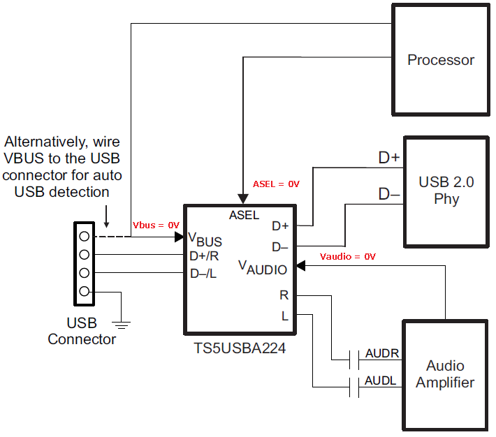

  • Hi Adam-san,
    Thank you for your quick response.
    Could you please concretely revise my incorrect understanding in the table which I mentioned although I understood that the device is not able to use when that is powered off ?
    Our use case which we is considering is shown as below again.
    I considered that the input signals clipped if TS5USBA224 has the esd protection diodes for D-/L and D+/R terminals since I would like to pass the audio source to an additional audio amp when that is powered off.
    So, I asked you those question.
    Kato
  • Kato-san,
    When the device is powered off, D-/L and D+/R = Hi-Z as shown in the data in the previous posts.  You may place an audio amp on the bus as you depicted.
    Thank you,
    Adam
