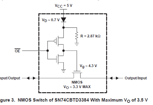

Finally in the device SN74CBTD3384 we can see in the figure before below the resistor R in order to have enough current for the diode.
I was not able to find the same figure for SN74CBTD3861, but i believe there is the same resistor and diode in SN74CBTD3861. I want also confirm that.

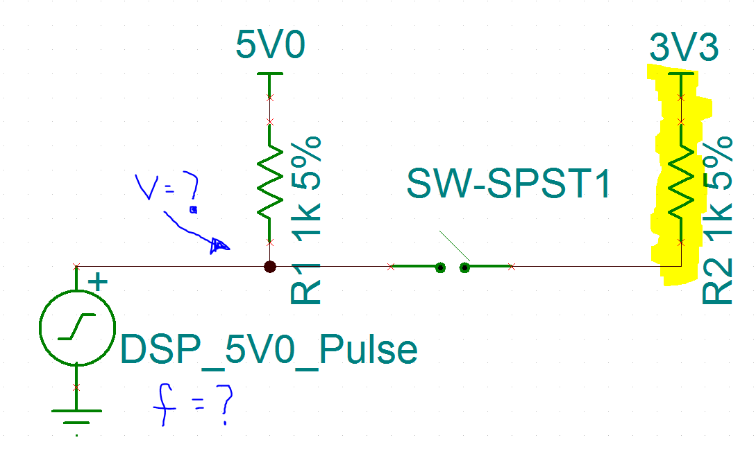

    This is what I imagine your circuit to be currently:
    If that is correct, then could you please provide the speed which you are pulsing the signal, marked in blue? Also what voltage does your customer see at that node?
    To address the first point your customer mentioned about the node under the high lighted resistor, this instance can be caused by a series of things. One of which being the power up sequence which the 3V3 turns on. If the 3V3 turns on later than the 5V signal gets there, then the same phenomenon I mentioned in the previous post will still happen. Could you please check that is not the case.

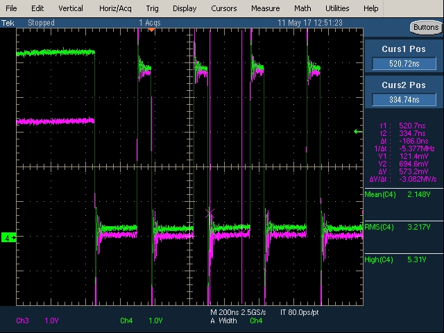

  • Hi Louie,
    Thanks a lot for your detailed reply.
    Pleas find below what my customer sent to me:
    First Case
    In the first one we see the input of the switch and the output of the switch, without pull up resistor in the FPGA side. The voltage of the VCC pin is 4.9V.
    As you can see, the input and the output are almost the same. There is no current consumption trough the switch.

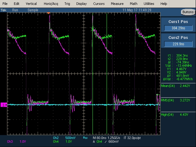

    In the second drawing we see input and output voltage of the switch, with a 1K pull up resistor to 3.3V in the FPGA side. The voltage of the VCC pin is 4.9V. Now, we have a current consumption but as you can see both of them start at the same voltage level during the first 40 nseg. Then, the output goes down till 3.3V more or less.

    This is an image with the FPGA programmed (without external resistor). Vcc is still 4.9V. The Input/Output pins of the switch are the same ones I sent you before in the image without pull up resistor.

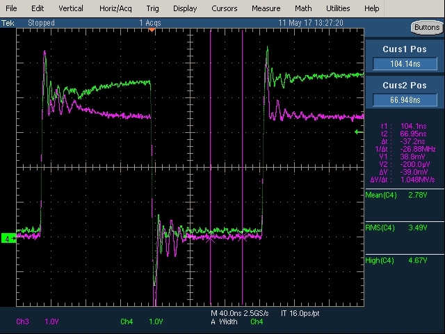

    Without FPGA programed, and without pull up resistor in FPGA side. Before the DSP starts switching the voltages input and output voltages of the switch are correct. The input is at 5.3V and the output is at 3.3V. After DSP starts switching the signal, the output starts following the input.

    If we look at the scenario you have presented in scenario 1 and 3, they contradict on another. How did you set up scenario 3? This scenario contradicts scenario 1 because if you it starts off at 3V3. My question would be, how did you set that output value to 3V3, or had you waited some time for it to settle to that value?
    Scenario 1 affirms what we had spoken about in the previous post. But if you look very closely at the second part of scenario 1 with a pull up resistor and scenario 2 that you posted (programmed FPGA), you will note that they are actually similar in behavior, just not settling time. In scenario 1, with a pull up resistor on the FPGA side, it settles very slowly to 3V3, where as in scenario 2, it settle quite quickly to 3V3. So in a sense, the pull up you place in scenario 1, is a mimic of what will happen when the FPGA is programmed.
    Now to discuss scenario 3, I was looking at the pulses of your scope traces, and the first thing I notice is that they are quite fast. However, scenario3 is the same as scenario 1(without the pull up resistor on the FPGA side), with the exception that it starts off with the output and the input are at the desired voltage levels. How did you get the voltage levels to the desired values, was it by means of:
