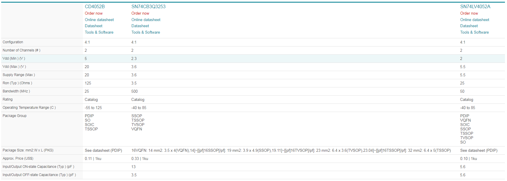

    There are many things that differentiate the 3 switches that you mentioned (Bandwidth, Max VCC, propagation delay, etc.), these specs are weighed depending on you design. I have attached the table below:
    This table can be easily done by finding the parts you wish to compare in our portfolio of parts:

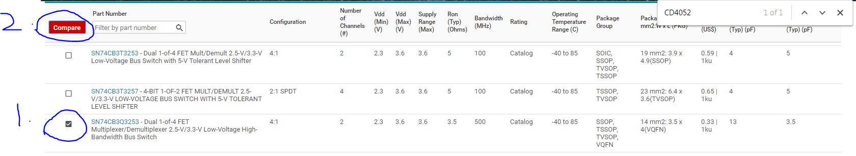

    and then:
    1) You select the parts you wish to compare
    2) You click them compare button
    As seen below:

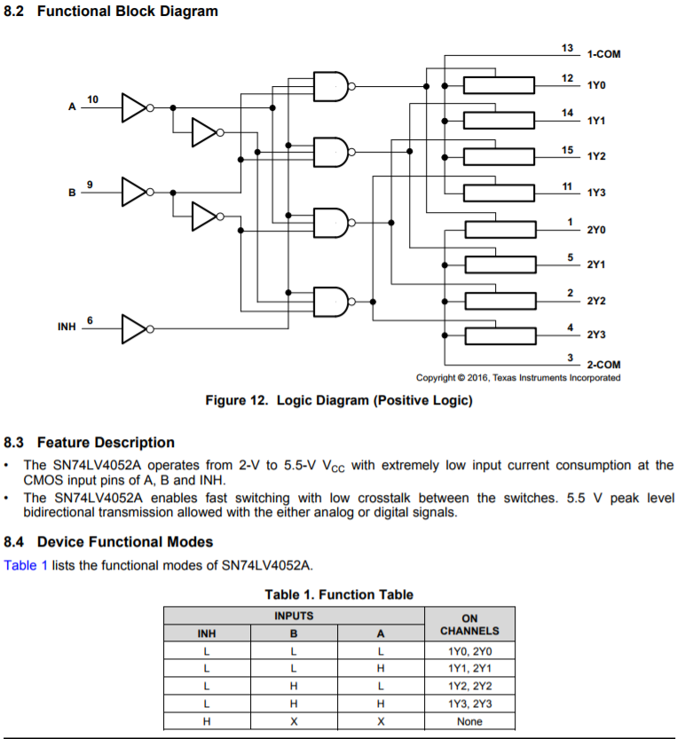

    Both the CD4052B and the SN74LV4052A have the same functional capability as you can see in the block diagram, and the functions table provided in the datasheets, and seen below. These two switch have have two channels which you can switch between 4 different inputs, but it is of the differential output, which means you will allow a pair of signals to pass each time.
    CD4052B snippet (Page 17 and page 18):
    Functional Block Diagram:
    Function States (the part and the truth table are highlighted and circled):
    SN74LV4052A Datasheet snippet(Page 12):

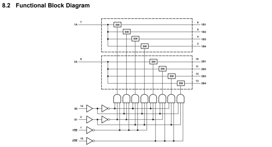

    As for the SN74CB3Q3253, this switch also has two channel with a 4 to 1 switching configuration, however the difference comes from the fact that this switch has 2 output enable (1OE and 2OE) pins. This means that this part has the capability of releasing a pair of signals at the same time, or individual sets depending on whether one or both enables are set low. This is also shown in the data sheet of this part. I have attached the snippet of such below:
    SN74CB3Q3253 Datasheet snippet (Page 9):
    Please note that in the functions table, the OE and the A and Bx ports are labeled without a number in front (highlighted), different than that of the block diagram. That is to show that circled portion (decoder bits) apply to both channels. This means that although you can dictate which channel lets a signal pass or not with OE, you cannot mix different paths between the two channels. If you pass B1 for channel 1, you will pass B1 for channel 2, meaning 1B1 and 2B1 will be active, assuming both 1OE and 2OE are Low.
