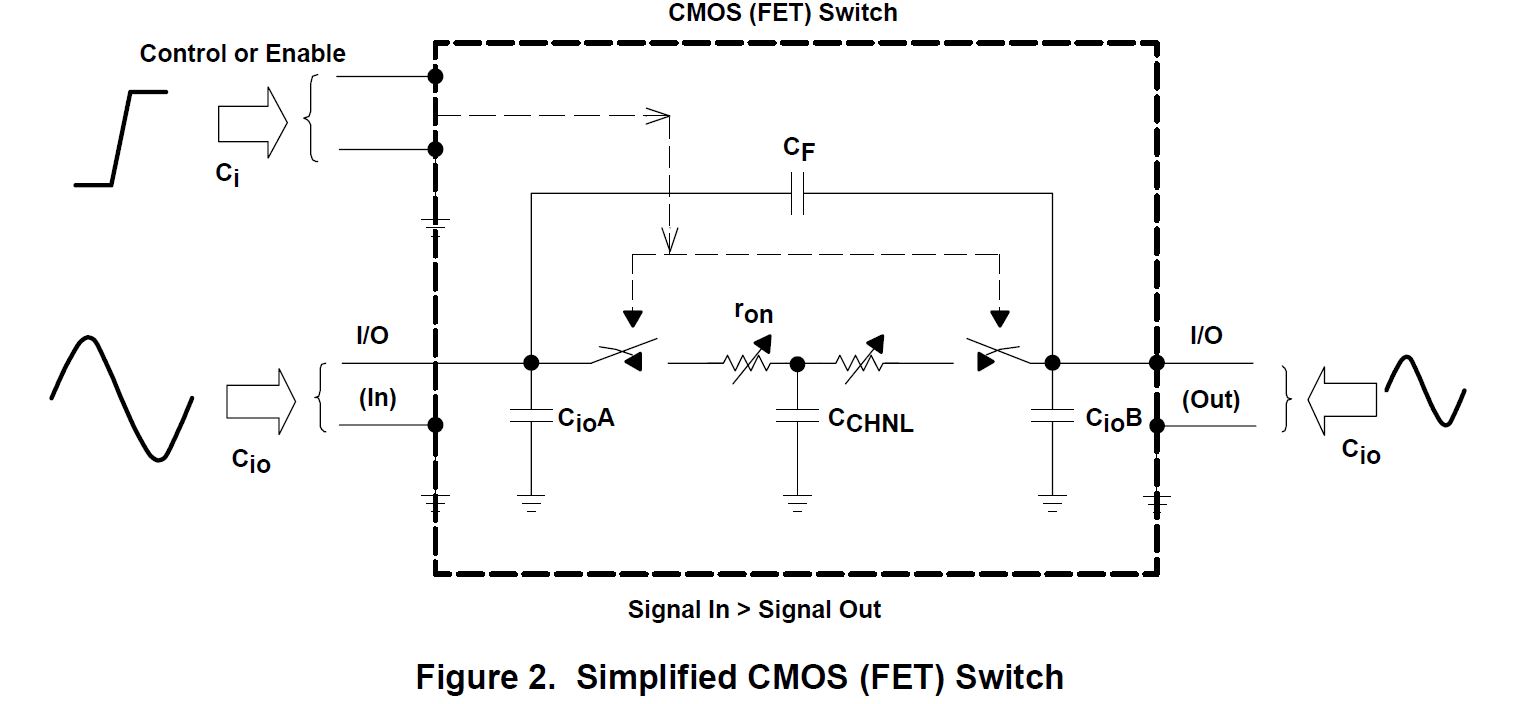

  • Dear Adam,
    Thanks for the Quick response,
    We want do the SI analysis of the new design of the PCB, so we need  TS3L110 IBIS model , can you please suggest the Equivalent   IBIS model for this.
    Thanks & Regards
    BVRK Prasad
  • BVRK Prasad,
    We do not have a model available and will not be able to make one easily since the part is older and in archived formats.
    However, you can get close with a model using the Ron and Con values in the datasheet with the equivalent circuit below.
