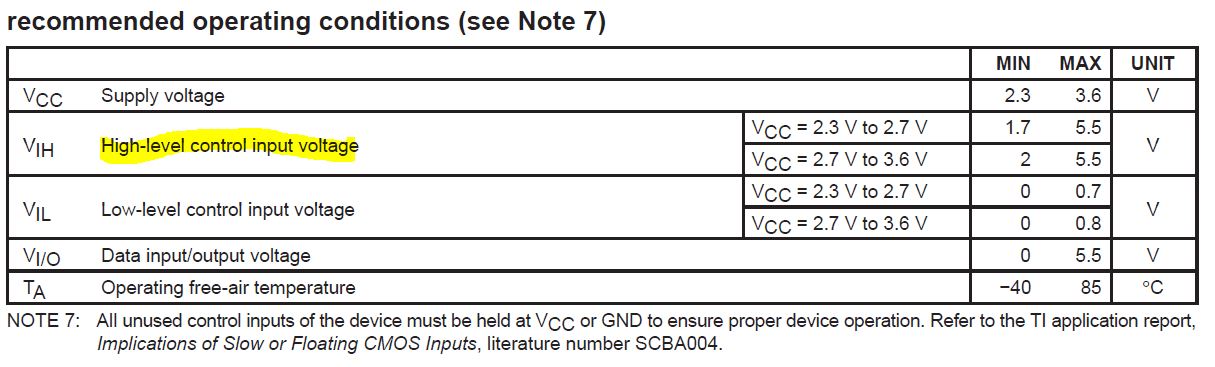

SN74CB3Q3244: SN74CB3Q3244 High-level control input voltage
Hi~ TI team
High-level control input voltage means output enable control voltage(OE)?
