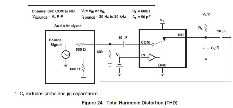

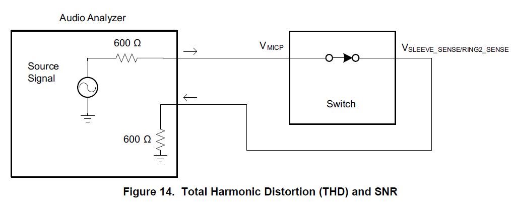

Hello Adam-san,
Thank you for your reply.
I checked datasheet of TS5A23159.
Then I found THD measurement information as below.
So,I thought that I could measure SNR with the same measuring circuit and asked a question.
Also, the device TS3A227E has data that measured THD and SNR under the same conditions shown in the figure below.
Y.Hasebe
