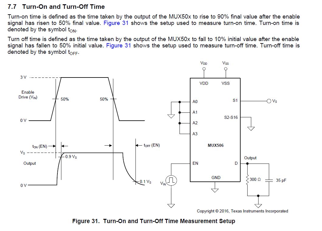

Is there spec information for MUX506 settling time?
If no information, please let me know way to equation.
Satoshi
  • Satoshi,
    The settling time for passive FET switches is going to depend largely on the system source and load since there isn't any drive capability.  You can predict the settling time using the Ton and Toff specification and the test conditions.
    What are you connecting to the switch that needs to have settling time as a concern?
