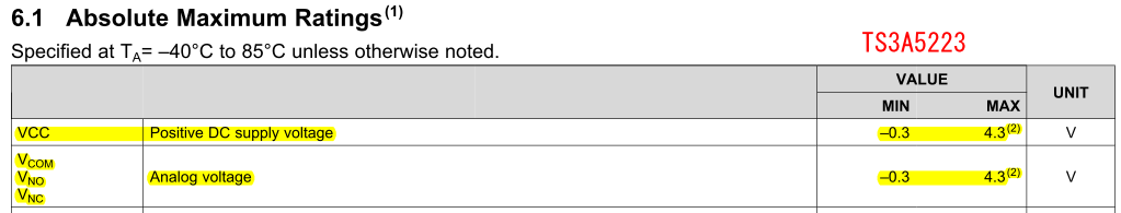

Q2). Since the absolute maximum rating is 4.3V, I believe the device would not get damaged even 3.3V applied to the NC/NO/COM pin when device not powered up. Am I correct ?
 One of the I2C master uses separate power suppy (bus pull up voltage) and there is a case where bus pull up is enabled and TS3A5223 is powered down.
Q3). What is the reason that the maximum recommended VNC/VNO/VCOM is limited to "VCC"  ?

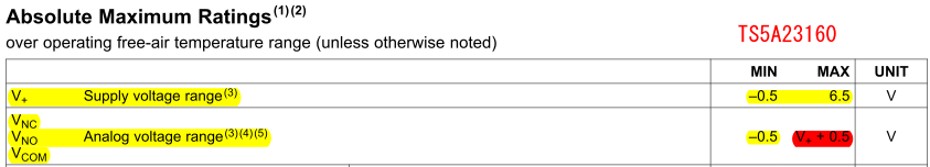

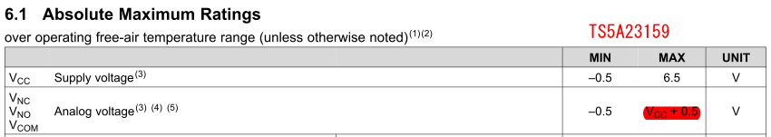

    Q5). Below are the absolute maximum ratings which is listed in the datasheet for each devices. My understanding is that TS5A23159/23160 cannot be used in this case since Absolute Maximum Ratings (AMR) is "VCC+0.5V". I believe these devices will be damaged if signal applied without VCC power supplied. Why can you recommend these devices ?
    Q6). TS3A5223 AMR for VCOM/VNO/VNC are 4.3V maximum. Recommended operating conditions for these pins are VCC. If I2C comunication can be ignored when TS3A5223 VCC is not applied can they use the device ? Or, does the device get damaged even used under AMR ?

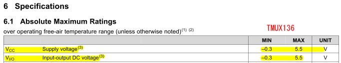

    Q7). TMUX136 seems to meet the requirement of applying signal without VCC power supply. However, customer wants to use at VCC = 1.8V. Do you have altenative solution ?
    Exceeds AMR if VCC is not applied.

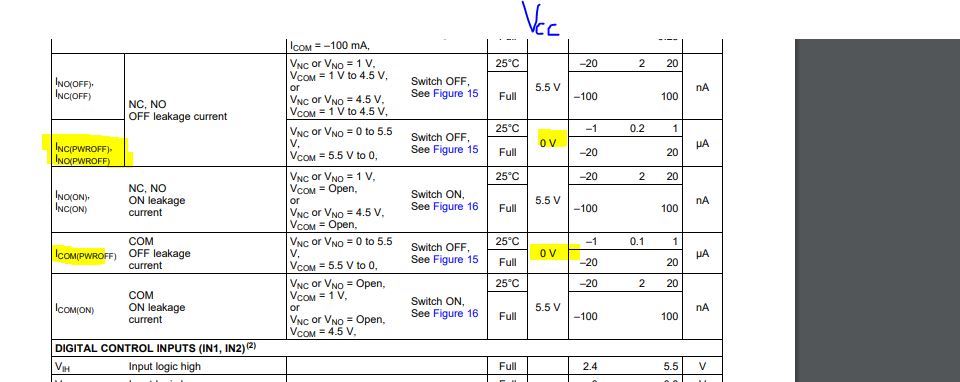

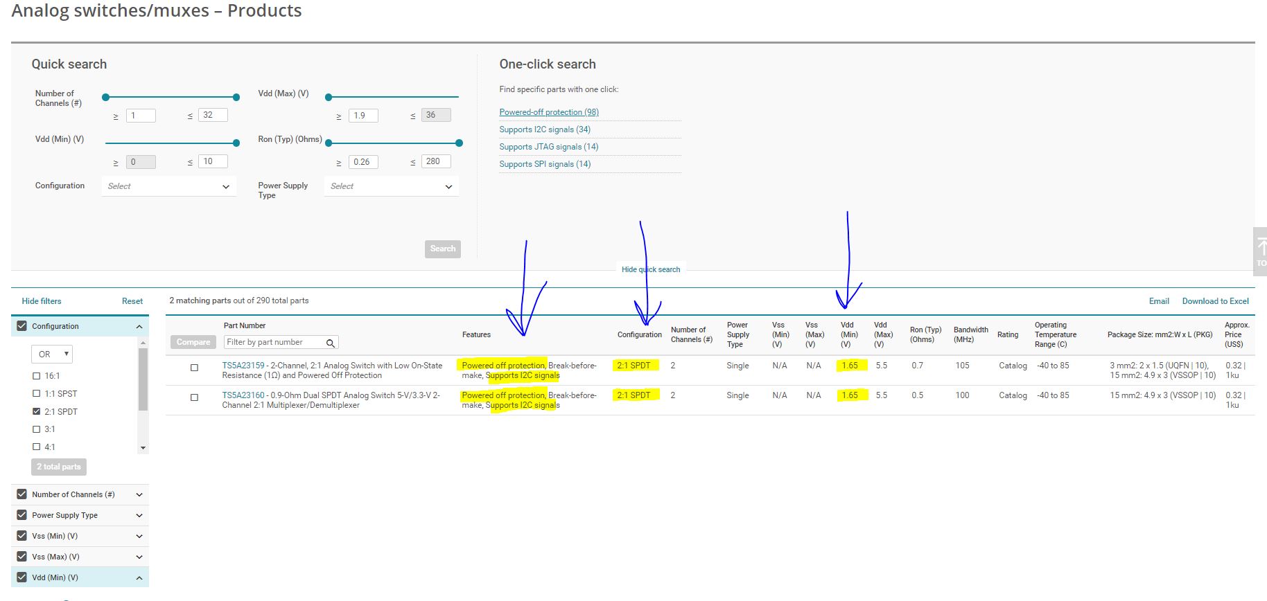

    Q4). How can we know if the switch supports "Power-off Protection" ?
    The ti.com switch selection tool has filters that can narrow down devices that are 2:1 configuration, have powered off protection feature, supports I2C signals, and Vdd min <1.8V.
    In the TS5A23159 datasheet you can see the leakage specification on the COM and NO/NC pins when Vcc = 0V.  This ensures that there will be a high impedance path from COM to NO/NC when Vcc = 0V.  This spec is only valid when Vcc =0V.  When Vcc is at any other value the absolute maximum rating spec of Vcc + 0.5V on the COM and NO pins comes into play.
    Please see the answer to Q4.  The powered off protection is only valid when Vcc = 0V.  If the Vcc node is floating it is possible that Vcc will not be 0V and the abs max rating must be observed.
    Q6). TS3A5223 AMR for VCOM/VNO/VNC are 4.3V maximum. Recommended operating conditions for these pins are VCC. If I2C communication can be ignored when TS3A5223 VCC is not applied can they use the device ? Or, does the device get damaged even used under AMR ?
    If you have Vcc =0V and the I2C communication is not present you can use any device in the portfolio. The TS3A5223 will operate with Vcc = 1.8V.
    Q7). TMUX136 seems to meet the requirement of applying signal without VCC power supply. However, customer wants to use at VCC = 1.8V. Do you have alternative solution ?
    If you can ensure Vcc = 0V during the powered off condition than the TS5A23159 or TS5A23160 would be good choices.
    Take a look at the new TMUX1511 device.  Its not the ideal configuration but has the specs I think you want.  You could tie out puts of the D1/D2 and D3/D4 to create effectively a 2-channel 2:1 device.

    Q8). Let's say the switch device is not power supplied yet, however,  "NC"  pin has 1.8V applied through pull up resistor which I2C bus connected from the other board.In this case, can the switch device stand for this continuous 1.8V voltage ?
    TS3A5223 doesn't have any powered off protection feature and clearly states recommended operating condition on NC pins as Vcc max.  If you are concerned about this operating condition this would not be the device to choose

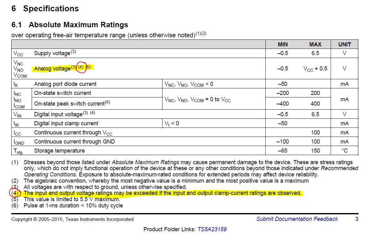

    Absolute Maximum Rating (AMR) of TS5A23159 NC pin is VCC+0.5V.
    IF the power sequece is ramped up [1st] I2C pull up voltage --> [2nd] TS5A23159 VCC, first of all it is exceeding the AMR.
    If this is protected by "Power-off protection", I agree.
    Then, how about at the timing where TS5A23159 VCC ramps up ?
    There is a timing where VCC=0V is not met, which Power-off Protection doesn't work.
    For example, there is a case where pin =1.8V and VCC pin = 0.5V (when VCC ramping up).
    Can you guarantee the device to operate correctly in this case and commit that the device would not be damaged ?
    TMUX1072 seems to be meeting all the requirements, however, it is overspec for I2C application and having high DC on resistance.
    Customer expectation is to use TS5A or TS3A analog switch. What would you say to the above opinion ?
    Kawai
  • Kawai,
    Please see note 4 of the absolute maximum ratings.
    When voltage on the signal path is greater than Vcc the ESD protection circuity can turn on and leak current to Vcc.  This is why the datasheet doesn't recommend this operation and can't guarantee the electrical characteristics stated in the datasheet.
    In an I2C application the series DC resistance is negligible because the pull up resistors will be in the 1000s of ohms any way.  The nice feature about the TMUX1072 is the beyond Vcc operation that it can support the recommended operating condition of the signal voltage being greater than Vcc.

  • Hi Adam-san,
    My apologies for my late response. Thanks for your continuous support.
    I understood that since in the use case of I2C, current is limited to the pull-up resistor which is more than 1k Ohm.
    If used in 1.8V level, current would be limited lower than 2mA. This is small current compared with the I_IK=50mA.
    As a conclusion, can I understand as follows ?
    "TS5A23159 can operate without damage in any case (any power up sequence) as far as it is used in 1.8V I2C application."
    We don't need to guarantee the operation during power up, however, no damage as long as it meets protection diode current limit.
    If there is any concern for TS5A23159 to be used in I2C application, please let us know.
    Kawai
