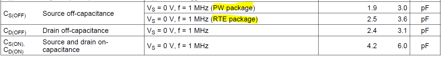

I want to know the Cs(on),Cd(on) relationship with Package ,for instance, TMUX6112, which has two package:16-Pin TSSOP and 16-Pin WQFN, the Cs(on) is equal?
I have another question, the SO-16 and TSSOP-16 have the same Cs(on)?

Hi De bi,
This question’s answer is device dependent. I will use TMUX6112 as an example here:
As shown in TMUX6112 datasheet screenshot below, the datasheet specifies that Cs(Off) is different between the package types. However, the Cd( Off), Cs(on) and Cd(on) have only one value listed. This means that the difference between packages is negligible so only one value is listed.
Thank you and please let me know if further questions.
