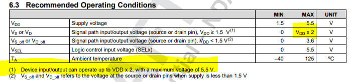

    I appreciate if you could consider the following expression in the table 6.3 of the datasheet.
    This description doesn't contain that the input/output acceptable voltage is 2*VDD in the condition of  VDD is more than 1.5V and less than 2.25V.

  • Hi Saito-san,
    Thanks for some feedback. Table 6.3 has been edited and looks like the following:
    The max voltage is listed as VDD x 2, with a footnote that the maximum can be 5.5 V. This will be updated on the web version soon.
    Does this help clarify any confusion?
  • Hi Dakotah,
    Very helpful! That became clear.
    Thank you for considering to modify the datasheet.
