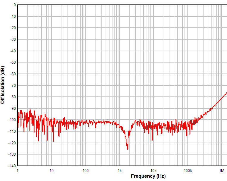

  • Whether can provide off isolation data below 100KHz as the same with above crosstalk?
  • Hi Chen YungJay,
    Here is the off isolation data below 100KHz. The off isolation performance is very good in your frequency range.
    The TMUX1511 is a good part for devices where crosstalk and off isolation data is a key concern.
