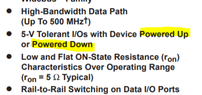

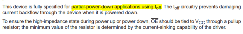

Hi, Oliver,
It depends what kind of feature you are looking for in hot-swap applications.

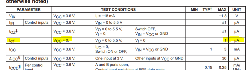

If you are referring to the case that the switch is protected and can withstand I/O voltage of up to 5V during a partial powered-down scenario (caused by sudden dip in the system power due to hot insertion) then the answer is YES. The SN74CB3Q16211 has a feature called powered-off protection that will make the signal path Hi-Z when Vdd=0V so could protect I/O pins behind the switch during sudden power plunge.

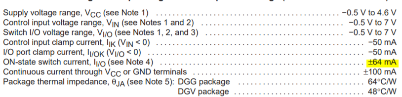

However, if you are referring to whether the SN74CB3Q16211 can handle large amount of in-rush current during hot-swapping event the answer is NO. The device is rated to handle maximum current of 64mA. The device also does not provide any short-circuit protection or fault protection. You would need a dedicated hot-swap controller for that.
