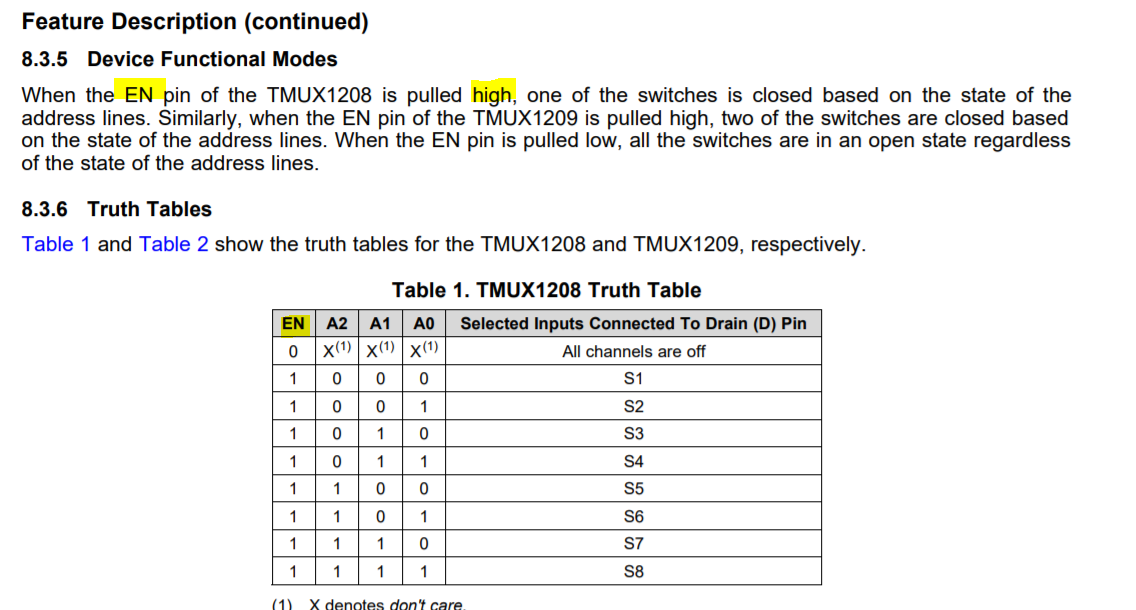

    Can you confirm that the EN pin is pulled high?

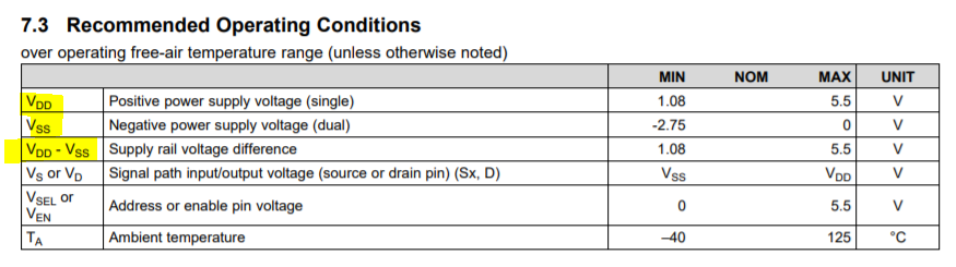

  • Hi. Yes I put 3V to the En pin, the same to the Vdd. To the GND I give -1.5V as a reference signal, so to the A0...A2 I put -1.5V as well when I want to have them low (S1 enable). To enable S2 for example I'm pulling A0 to 0V and A1 and A2 to -1.5V so it should be situation just as in the datasheet. Right now I;ve replaced the old Tmux for a new one but the problem still occurs. I'm giving a sine wave to the D pin. it's -700mV to -70mV more or less.
  • Hi Mariusz,

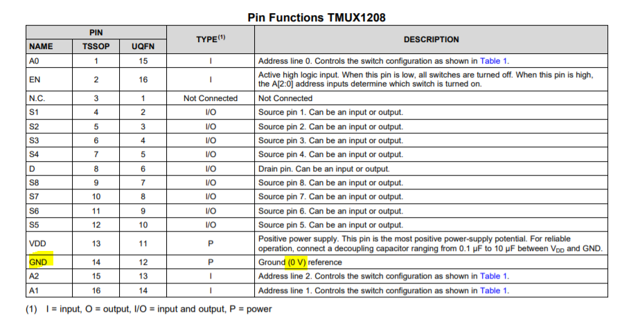

    If you look at the pin functions table for TMUX1208, it specifies to have GND to 0V reference.

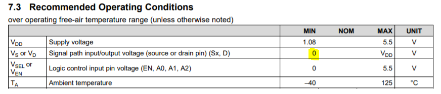

    Also mentioned in the recommended operating conditions of this part,  Vs or VD range from 0V to VDD.
    Can you try setting GND to 0V and pull the A pin to 3V when you are switching between channels?
    Also, please look at TMUX1108 that has same configuration as TMUX1208 but offers wide dual supply Range: ±2.5 V, 1.08 V to 5.5 V.
    Using this switch, you can set VDD to 3V, VSS to a negative -1.5V, and maintain the supply rail difference of 4.5V which is in the recommended operation conditions of TMUX1108 as shown below.
