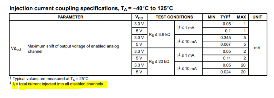

I will use the 4851-Q1 . What will I see the output voltage of an disable channel when injection current ?

Hi Omur,
The VΔout spec in the datasheet shows the output induced due to injected current Ii on the unused channel. Note that the Injected current on unused channel does not impact the enabled channel path significantly
In similar configuration, we have the new TMUX1308-Q1, offering more features like the 1.8V compatible control inputs, break-before-make along with current injection control.
Please let me know if you have more questions about the TMUX1308-Q1.
