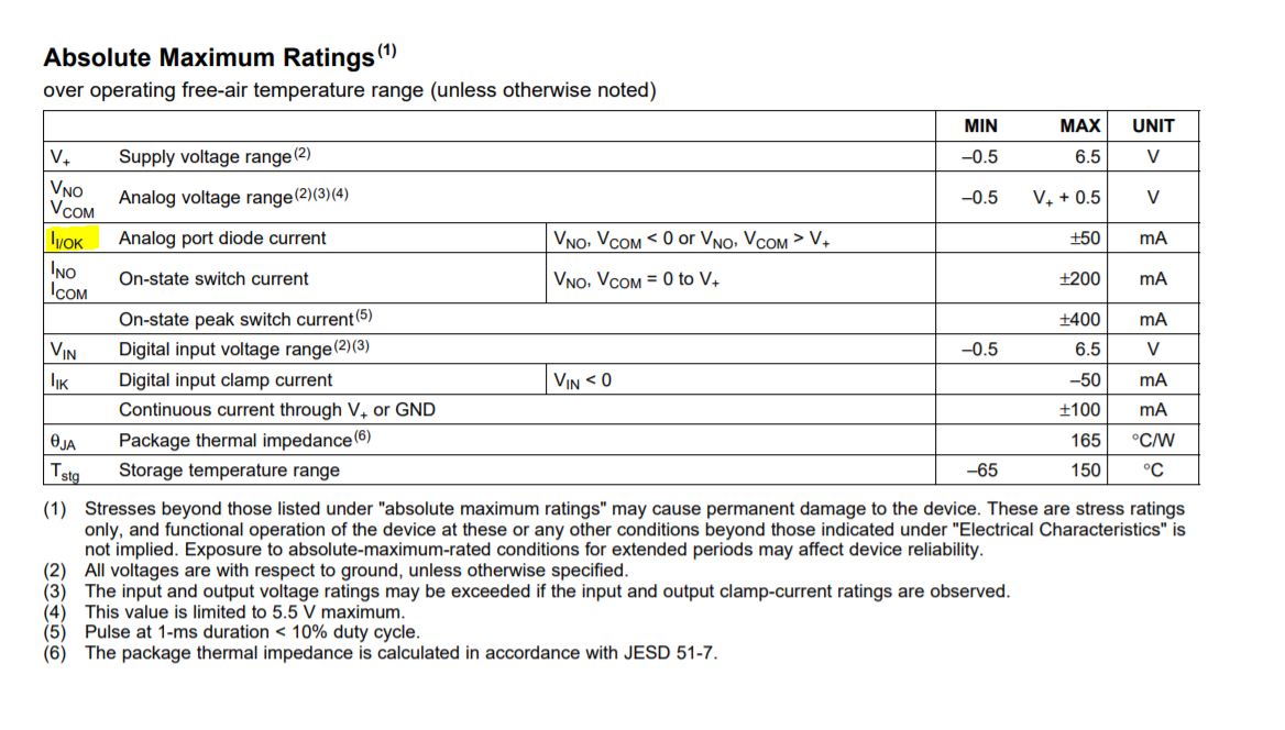

Is there an internal connection between the COM and GND pins on the subject PN?

HI Saminah,
Thank you for the information. In follow up:
HSG
Hi HSG,
Both the FET driver and the FET share the same substrate that is electrically connected to GND. All voltages defined on our datasheets are with respect to GND.
