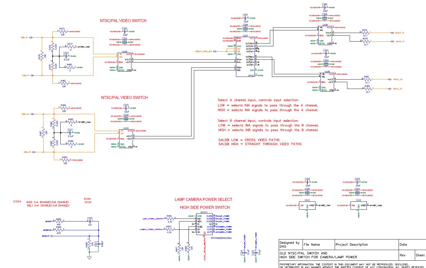

  • Hi Saminah,
    I do not see the common mode voltage specifications of the TS3D10224.
    My common mode voltage is 1.75V and signal swing is +/- 0.5V, 1Vp-p.
    I believe the signals will pass through without any issues.
    I have a very short input path from a video filter approximately 350mils and a very short output path that terminates into a high impedance (800K) input video filter input approximately  400 mils.
    Since these paths are well below any critical length it is unnecessary to have 50 ohm termination. If you feel otherwise please advise me.
    Also I do believe the pins are generic labeled so that I can switch INA+ with INA- to reduce any routing vias. Do you agree with this?
    I am passing buffered NTSC signals through the switch so the signals are not floating.
    If you see any issues in the diagram I have posted please relate them to me.
    Your advice is greatly appreciated.
    David
  • Hi David,
    Yes, the common mode voltage is not spec'd in the datasheet but you should be ok with the signals you mentioned - keeping them between 0-Vcc.
    I don't see need for 50Ohm termination - you can find more details in the the layout guidelines in the datasheet (section 11)
    The pins are generic labeled so you can switch INA+ with INA- (they both represent A channel signal path) as shown in pin functions table. It depends of what signal you place on them.
    The schematic looks ok.  The Vcc has proper decoupling, SAI, SBI, SAO, and SBO are properly pulled up to VCC or down to GND to avoid undesired switch positions that could result from a floating pin, signal pins look good.
    Saminah
  • Hi Saminah,
    Are you referring to 50 ohms termination on the unused pins OUTA1x and OUTB1x pins?
    I have added them as they are not in the original schematic.
    Since these pins are never used to the need to be terminated? or will unterminated OUT pins create noise within the IC?
    I believe that the output from the ADA4433-1 video filter to the input of the TS3DS10224 inputs do not need any termination since I am well below the critical length. The signals I am referring to are INAx and INBx additionally the OUTA0x and OUTB0x pins to the input of the  ADA4433-1 CAT6 drivers do not need termination.
    These pins have a very short path with INAx,Bx approximately 500mils and OUTA0x,B0x approximately 225 mils.
    If you think termination is needed on used signal paths please let me know.
    I greatly appreciate your advice. I am in the final routing phase today and releasing the project tomorrow.
    I look forward to your response.
    David
  • Hi Saminah,
    Sorry I misread that you do not see the need for 50 ohm termination.
    Do you need to add termination on the unused OUTA1x,B1x pins/
    The datasheet says that you should terminate them however I am working in an extreme limited space area of the pcb.
    Please let me know if I can omit these termination resistors on ununsed output pins.
    David
  • Hi David,
    Unused pins for the signal paths INA, INB, OUTAx, and OUTBx must be terminated with a 50-Ω resistor to ground to reduce signal reflections in high-speed applications.
    You can run into signal integrity issues if you do not use proper termination on unused signal paths.
    Saminah
  • Hi Saminah,
    High speed is relative to the design parameters of any system. I have approximately -55dB on my video signals and the rise time is considerably slow at 200-300ns.
    There are certainly no reflections at this rise time.
    Given this as the specification for NTSC video it would suffice to render usage of 50ohm termination ineffective.
    Although adding them does not degrade  signal integrity.
    Would you agree that this is more or less the correct way of analyzing the usage of these 50 ohm termination resistor?
    I would think they are not needed in this particular application. I know what the datasheet says and it is relative to "high-speed applications".
    Your feedback is always welcomed.
    David
  • Hi David,
    Yes, your understanding is correct.
    For your application, if you don't see any impact on signal, you should be ok without the 50 ohm termination on signal lines.
    This video (just like the datasheet) highlights when having the termination is important.
    Saminah
