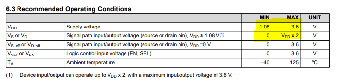

    However, if you're looking for a 4 channel 2:1 switch that allows you to have 1.8V on the power supply and still work beyond the rail and pass through a 3.3V signal, take a look at the TMUX1575. It can handle what you're aiming to do.
    It provides powered off protection to eliminate power sequencing concerns and protect devices down stream, is 1.2V logic compatible and has an integrated pull down resistor on the logic pin too. It's a good part and I'd recommend taking a look.
