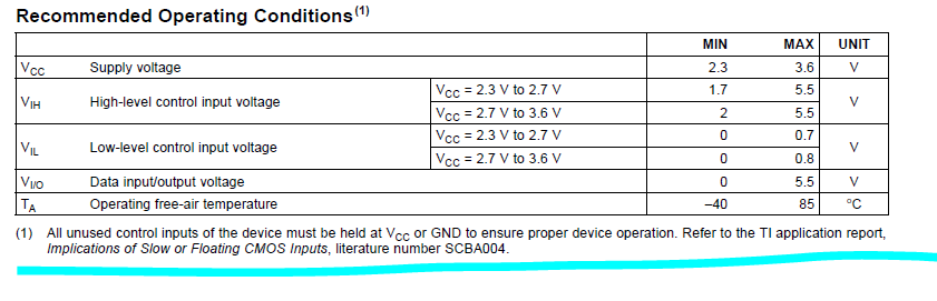

My customer is using the device SN74CB3Q3253 now. We want to check whether we need to pull up or pull down the 2OE oin, if we just use the channel 1 function. Thanks.

We also need to connect it even if we didn't use the channel, correct? Thanks.

Thanks for your help. Could you please share the risks if we float the pin(even if we didn't use the channel)? Thanks.
Hey Frank,
As Clemens mentioned, It's good practice to give the OE pins a known state. Here it's better to just disable 2OE by running it high and holding that state. By floating the pin the floating pin can pick up noise (it's essentially an antennae now) and will fluctuate somewhere between it's high state and low state. From a functional stand point, you may see the same results on your Vi/o line that you're using. However, from a holistic view, keeping the OE pin floating of the unused channel will essentially give you a condition where both high-side and low-side of the FET are simultaneously turned on resulting in a current spike.
