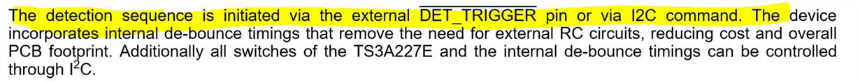

May I leave the TIP pin floating on the TS3A227E (audio jack switch) and trigger detection sequence with CPU_GPO for a USB type C audio application?
Other Parts Discussed in Thread: TS3A227E
Question on behalf of customer:
So far, I can control the TS3A227E EVM board and the basic function is work.
But I still have two questions about the TIP pin and switch. Could you help to clarify it?
  1. Could we use CPU_GPO for the trigger even and  keep Tip pin to floating?
2. What are the switch-OFF resistance or Isolation performance for these switch (RING2GNDFET, SLEEVEGNDFET, RING2DFET, SLEEVEDFET)?
