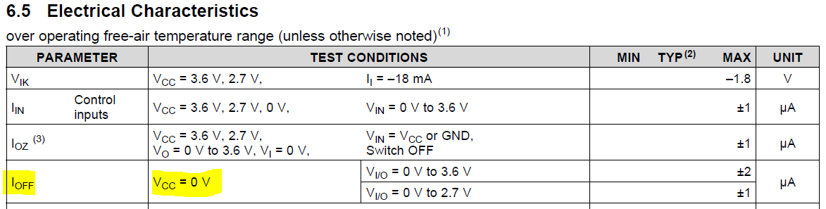

    If you would like a device that is in Hi-Z state when Vcc= 0v you need to find a device with Ioff or Ioff protection like the spec below from the TS3USB221.  It shows that there is little leakage through the signal path.
    Why do you need to have the device Hi-Z when Vcc = 0V in your system?  Would you be able to use the 2 channel 1:2 TS3USB221 device instead of the TS3A24157?

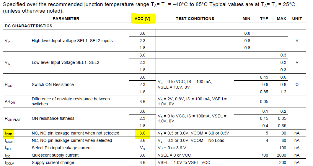

    No, the TS3A5223 is not allowed to apply the voltage at the analog input when VCC=0V.  Our datasheet naming for these specs is currently not consistent.  If you look at the Ioff spec in the TS3A5223 it shows that the Vcc = 3.6V during the test.  You need to find a spec with Vcc=0V and placing a voltage on the signal path to see if it leaks to the other side of the FET switch.
