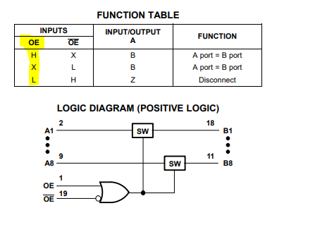

Hi Shashank,
is there a possibility, that there is a part, pin2pin, of course, that does everything that SN74B3Q3245 does, just invertet?
So this table
But when OE is low, nothing should be connected internally,
Kind regards,
Marion

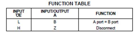

  • Hi Marion,
    What do you think of the SN74CB3Q3345?  It has OE pin active-high..
    What is driving the need for active high OE pin in system? What are using using the switch for?
    Saminah
  • Hi Saminah,
    first of all sorry for copying the mail with the wrong name!
    I proposed this part to the customer. The reason behind it was a superficial mistake to put an inverter in front of the OE pin.
    But it was hard to search for the exact opposite.
    I will get back if there are more questions,
    kind regards,
