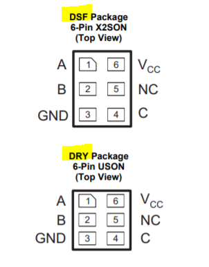

Sorry I forgot to mention.
Which package may close to the spec with SN74LVC1G66DSF?
Hi Masayoshi,
The IBIS model is available on the SN74LVC1G66 product folder page under Design & development here.
The DSF package pinout matches the DRY package pinout as shown in the datasheet.
