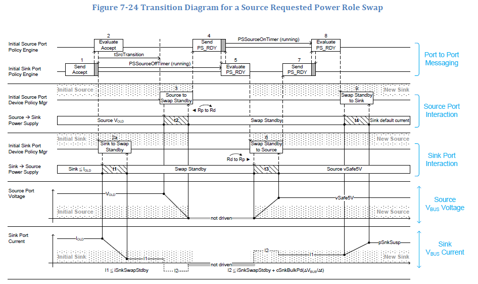

    If the PD Controller is setup to initiate a Power Role Swap directly after connection is detected (device powers the host), the host never provides power to the device first, correct? (That is, before 5V is applied on VBUS, the Power Role Swap happens)
    • False, a power role swap occurs after the initial 5V connection has been made. Below is a screenshot from the USB Type-C PD spec giving an example of what the message sequence should look like for a Source initiating a power role swap
    • You can see in the row labeled "Source Port Voltage", that there is a initial voltage on VBUS from the old source, and then a transition where the new source is supplying 5V to VBUS
    Step Initial Source Port -> New Sink Port Initial Sink Port -> New Source Port
    1 Policy Engine receives the Accept Message. Policy Engine sends the Accept Message to the Initial Source.
    2 Protocol Layer receives the GoodCRC Message from the Sink. The Policy Engine tells the Device Policy Manager to instruct the power supply to modify its output power. Protocol Layer receives the GoodCRC Message from the Initial Source. Policy Engine starts the PSSourceOffTimer.
    2a The Policy Engine tells the Device Policy Manager to instruct the power supply to transition to Swap Standby. The power supply Shall complete the transition to Swap Standby within tSnkStdby (t1); t1 Shall complete before tSrcTransition. The Sink Shall Not violate the transient load behavior defined in Section 7.2.6 while transitioning to and operating at the new power level. Policy Engine starts PSSourceOffTimer. When in Sink Standby the Initial Sink Shall Not draw more than iSnkSwapStdby (I1).
    3 tSrcTransition after the GoodCRC Message was received the power supply starts to change its output power capability to Swap Standby (see Section 7.1.10). The power supply Shall complete the transition to Swap Standby within tSrcSwapStdby (t2). The power supply informs the Device Policy Manager that it is ready to operate as the new Sink. The CC termination is changed from Rp to Rd (see [USB Type-C 1.2]). The power supply status is passed to the Policy Engine.
    4 The Policy Engine sends the PS_RDY Message to the soon to be new Source. Policy Engine receives the PS_RDY Message and stops the PSSourceOffTimer.
    5 Protocol Layer receives the GoodCRC Message from the soon to be new Source. Policy Engine starts the PSSourceOnTimer. At this point the Initial Source is ready to be the new Sink. Protocol Layer sends the GoodCRC Message to the new Sink. Upon evaluating the PS_RDY Message the Initial Sink is ready to operate as the new Source. Policy Engine tells the Device Policy to instruct the power supply to operate as the new Source.
    6 The CC termination is changed from Rd to Rp (see [USB Type-C 1.2]). The power supply as the new Source transitions from Swap Standby to sourcing default vSafe5V within tNewSrc (t3). The power supply informs the Device Policy Manager that it is operating as the new Source.
    7 Policy Engine receives the PS_RDY Message and stops the PSSourceOnTimer. Device Policy Manager informs the Policy Engine the power supply is ready and the Policy Engine sends the PS_RDY Message to the new Sink.
    8
    Protocol Layer sends the GoodCRC Message to the new Source.
    Policy Engine evaluates the PS_RDY Message from the new Source and tells the Device Policy Manager to instruct the power supply to draw current as the new Sink.
    Protocol Layer receives the GoodCRC Message from the new Sink.
    9 The power supply as the new Sink transitions from Swap Standby to drawing pSnkSusp within tNewSnk (t4). The power supply informs the Device Policy Manager that it is operating as the new Sink. At this point subsequent negotiations between the new Source and the new Sink May proceed as normal. The new Sink Shall Not violate the transient load behavior defined in Section 7.2.6 while transitioning to and operating at the new power level. The time duration (t4) depends on the magnitude of the load change.
