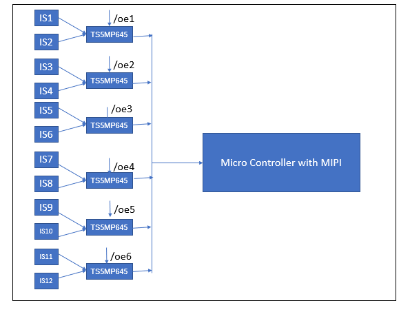

TS5MP645: Can I short 6 TS5MP645 outputs, control using /OE and connect to one micro controller MIPI interface ?
Part Number: TS5MP645
I have an application in which 12 camera sensor outputs are to be read  to a Microcontroller. Sensors are having MIPI outputs.
I  am using 6 numbers of TS5MP645YFPR , shorting its outputs, controlling /OE and SEL of  each of these 6 MIPI MUX from micro controller.  MIPI clock speed is around 12 Mhz.
Could you please confirm whether this  scheme will work fine ?
Block diagram is below.
Thanks & Regards,
Anil
  • Hi Anil,
    The biggest consideration if you are trying to do something like this, is that you have to make sure that only one MIPI switch is active at a time, if two switches are active at the same time then you could have data-corruption issues.
    Also, by shorting all the outputs together like that you also increase the capacitive loading of the output of the switch. The On-Capacitance and Off-Capacitance of each switch is the same at 1.5pF, so the capacitive loading at the output of the switch would be 9pF. At 12MHz though I don't see this being a concern, but this configuration will decrease maximum system bandwidth.
    If you take those considerations into account during the design process; there shouldn't be an issue with the application you have presented.
    Parker Dodson
  • Thanks Parker Dodson for the quick and detailed reply.
    Will take care of both the points you mentioned and go ahead with this configuration.
    Anil
