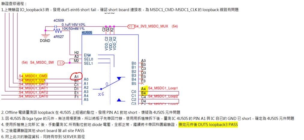

Dear Rami
As in was it previously soldered or was this probed initially out of packaging? If so what are the operating conditions? Could you probe the traces to see if there are any connectivity issues here?
Ans:Assembly with taping stock.(peak reflow temperature : 220+/-5℃)
Additionally, how is the handling of the device being managed? Is any extra ESD protection such as a wrist strap being used?
Ans:We all wear anti-static wrist strap to work, the task was carried out on ATE machine with whole ESD protection.
Please have a reply.
Thanks~

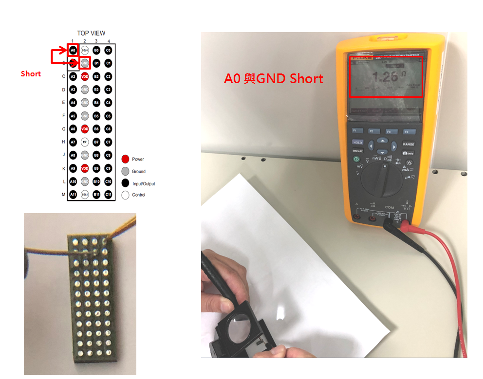

  • Hi Daniel,
    Thank you for providing this information again.
    This is your test condition: You are reading 1.26 ohm resistance when probing A0 to GND with a portable multimeter. The device is powered down VDD = 0V.

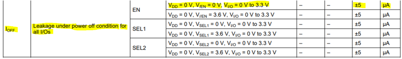

    TS3DDR4000 has the powered-off protection feature. This means that there is internal protection circuitry to protect the inputs and outputs and the power rail when the device is powered down.
    Image from datasheet table above shows low leakage current when device is powered down, the device has powered-off protection.
    Multimeters such as this one have an internal battery that applies a voltage across the probes and measures the current to calculate the resistance.
    When you probe the input with this multimeter, you are applying a voltage to the input (VAO > 0V) while TS3DDR4000 has no power supply (VDD = 0V). Powered-off protection ensures that the switch's signal path is high impedance and that the power rail is not back-powered (no signal path to VDD). This internal protection circuitry provides a path for this multimeter voltage to GND to prevent damage to the signal path or power rail. This path is the resistance you have measured -- not a device "short problem". An actual short circuit will read a much lower resistance (such as touching the two probes together).
    Based on what you have provided, I do not see an issue.
