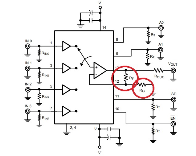

  • Hello Rami, well this check the diagram, my question is about Rf and Rg because i assume Rin and Rout will be 75 Ohm resistor right? and Rt will be 10K to provide gnd to the input when they are open

    It looks like you attached an image that didn't quite go through. Do you mind giving it another go?

  • Hello Rami, yes the image is attached again.

  • Hello Rami, well when i tried this again my source got damage and also my IC was damaged too, so I couldnt try this again, however i got the LMH6574MAX IC, i would like to know a circuit that can works to test it, can you help me with this please?

  • Hello Eduardo,
    You can begin with the block diagram in the datasheet of the LMH6574. For Rin = Rout = 75-ohm for termination (you mentioned you are using 75-ohm system), RF = RG = 575 ohms for gain of 2, and depending on rise time of digital signal & distance they need to travel you may or may not want to apply termination for RT.
    Hasan Babiker
  • Hello Hasan, thank you for answer, my sorry i was very busy, ok will check this, however for resistor a 575 Ohm is not a commercial value, can i use 560 instead?
  • Hello Eduardo,
    It would be better to go up rather than down in resistance. Since this is a current feedback amplifier, RF has a large effect on the stability of the device. While lowering the resistance may add more ringing (probably not enough to go unstable just going from 575 to 560) adding a larger resistor will just lower the bandwidth slightly and increase noise.
