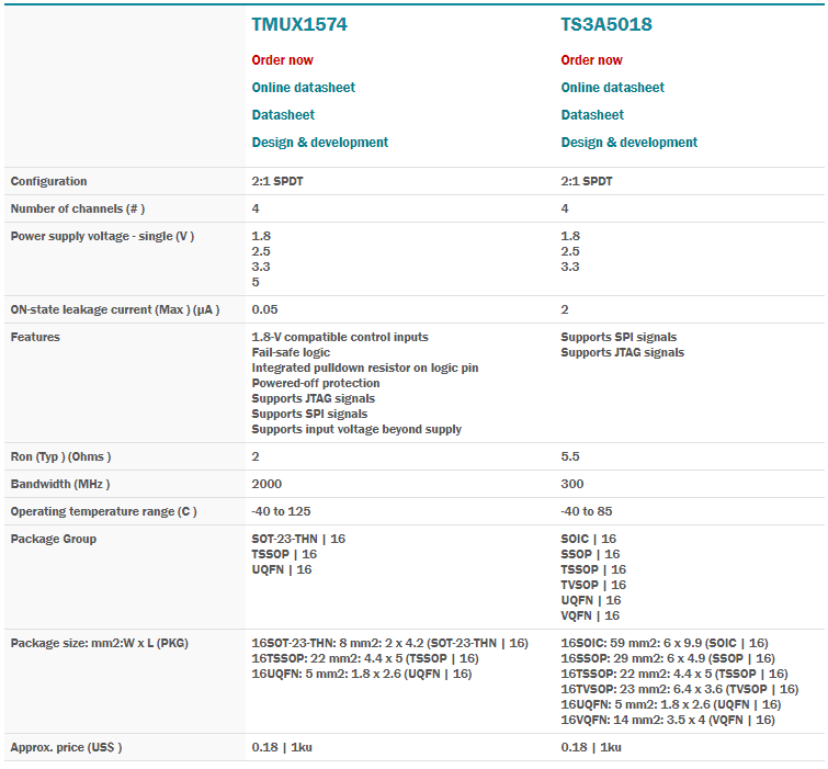

I have a customer interested in the TS3A5018RSVR and TMUX1574RSVR. Do we have propagation data on these products?
  • Hi Jon,
    Thanks for reaching out. Out of these two devices, I recommend using TMUX1574. Please take a look at the comparison table below, which highlights the improved specifications and added features of TMUX1574. Propagation delay for TMUX1574 in RSV package is 50 ps. You can find this on page 8 of the datasheet. What is your application/use case for which you are concerned about propagation delay?
