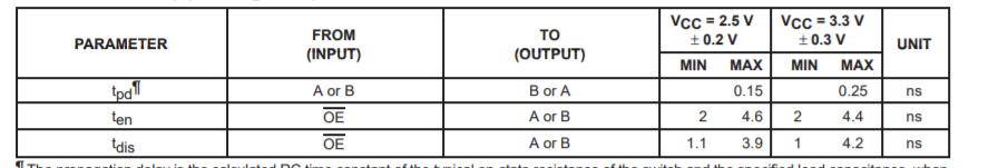

Hello Team,
Customer want to know the difference between these two parts, and I fond all the parameters are same from the datasheet, so could you kindly help us check this question?
Antony
  • Hi Anthony,

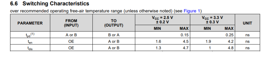

    The differences are subtle - there are slight differences in the switching characteristics:
    3125:
    3126:
    The 3126 has a slightly faster t_en times and slightly slower t_dis times than the 3125.
    And as Clemens has mentioned the 3125 is active low while the 3126 is active high.
    Besides that the parts are very similar.
