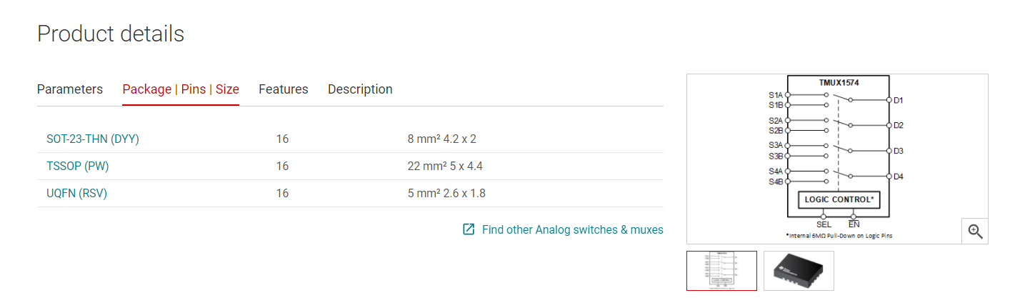

    If possible - we do have a multi-chip solution that will help lower Capacitance - and I think that might be the root cause of the issue.
    The TMUX1574 is a 4 channel 2:1 switch with low capacitance -> you won't be sacrificing performance, and you can possibly shrink footprint for this switch with two of these (size comparison below), and regardless of package type 1ku pricing will be lower for the 1574 (2 1574's is < than 2  TS3A27518E's). The Unused ports of the 2nd TMUX1574 can be terminated to help improved high speed performance with 50 Ohm resistors.
    TS3A27518E Package Options and footprint size:
    TMUX1574 Package Options:

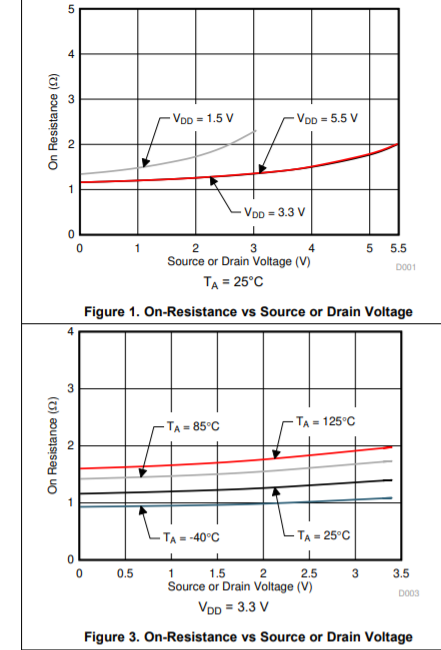

    2. On Resistance - This part has flat on resistance which allows it to maintain a pretty consistent on resistance across supply voltage. For a 3.3V supply the on resistance will look like this across temp:
    For the 3.3V supply at 25C (bottom graph - black line) There is a slight increase with input voltage (from 1.1 ohm to 1.4 ohms)
    Even when operating at higher temperature the resistance doesn't change much or rapidly so it will pretty consistent for all channels.
