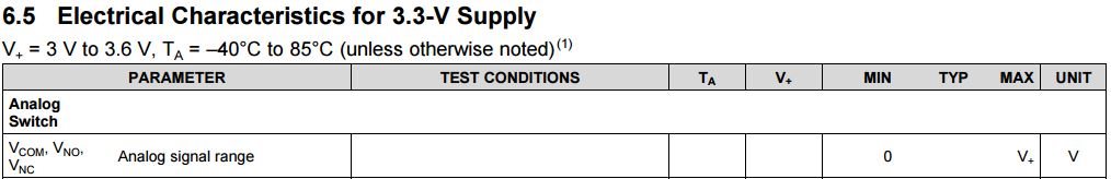

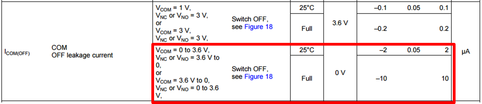

Hello Team,
I'd like to ask you about TS3A5018.
Can voltage apply to the COM pin of TS3A5018 when V+ = 0(GND)?
I recognize that TS3A5018 has ioff feature.
However I found the following description. Then I confuse.
Could you suggest similar TS3A5018 with off-isolation if TS3A5018 doesn't have ioff feature?
