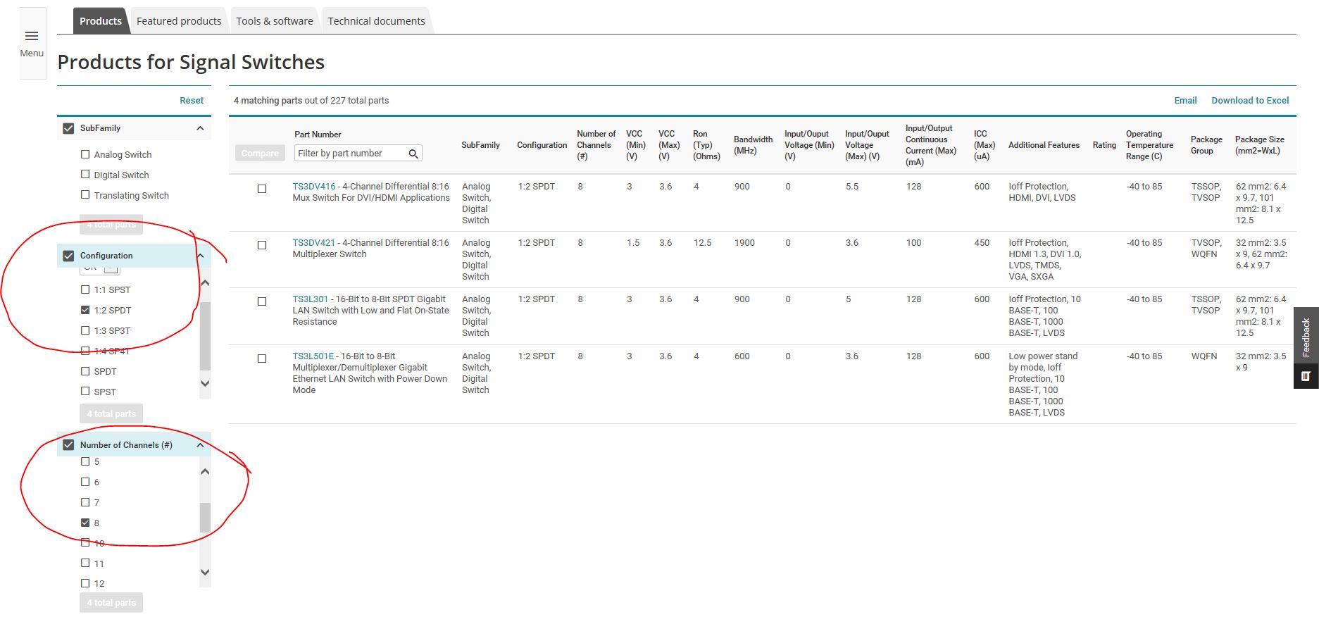

Can you suggest me the part for 8-Channel, 1:2 MUX/DEMUX Switch.
Can i use TS3L301 , as my application is single ended.

You may use the TI.com switch selection tool and use the filters on the left hand side for 1:2 SPDT switches that have 8-channels.
You can also look at our FAQ page to see that differential switches may be used in single ended applications.
