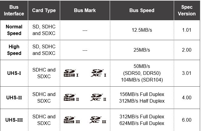

The TS3A24159 device hast a bandwidth of 23MHz which should be able to handle ~15Mbps (SD Normal speed), start to become marginal at SD high speed (25Mbps), and not be suited for UHS-1 and faster.
We recommend our switch bandwidths based on the formula data rate x (3/2) which provides some margin about the theoretical minimum data rate x (1/2). For example UHS is 104Mbps we would like to find a switch with >156MHz bandwidth. You can see more information on bandwidth vs datarate on the switches and multiplexers FAQ page below.

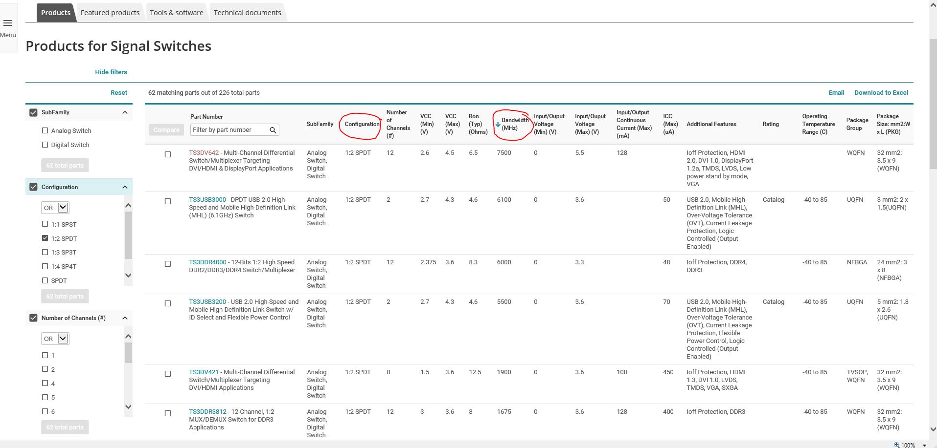

Here is a list from TI.com switch selection tool for 1:2 switches sorted with bandwidth greatest to least. You would need to select a switch with the appropriate bandwidth for the type of SD card application you would like to support.
Adam,
Isn't TS3A27518E bandwidth 240MHz? I don't follow your previous comment about 23MHz bandwidth.
