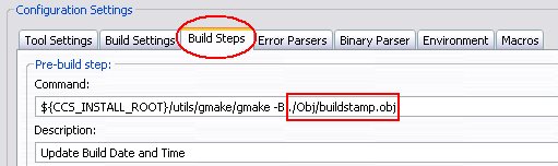

  • I figured it out.  It is so simple once you know the answer.  ;-)
    Under "Build Properties..." select the "Build Steps" tab.  In the Pre-build step Command, type
    ${CCS_INSTALL_ROOT}/utils/gmake/gmake -B ./filename.obj
    with the "filename" being the name of the C file that needs to be always rebuilt .
    I normally have my object files placed in an "Obj" directory, so in my case, I actually have what is shown below.

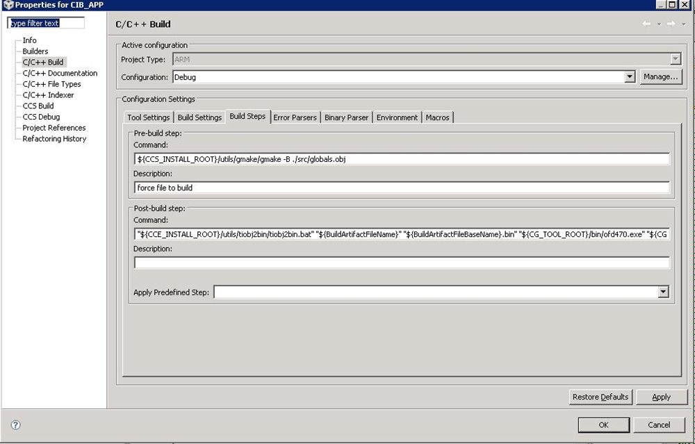

  • I did try what quark did and when it didn't work, I wanted to know what syntax is and what it means so I can get it working.
    The file I want to delete is in the path C:\svngcb_proj\Stellaris\CIB_APP\Debug\src and the file is globals.c
    I have tried:${CCS_INSTALL_ROOT}/utils/gmake/gmake -B ./Debug/src/globals.obj
    and ${CCS_INSTALL_ROOT}/utils/gmake/gmake -B ./src/globals.obj
    and ${CCS_INSTALL_ROOT}/utils/gmake/gmake -B ./globals.obj
    With no success yet.
    Doug

  • I copied the line exactly as you had it and I do not see the file globals compile each time I compile.
    I am using a Stellaris CPU and Code Composer Studio 4.2.1.00004.
    When I manually delete the file globals.c and compile, I see the file compile in the console window.  If I do not delete the file globals.obj I would expect if the pre build step worked correctly, I should see the file globals compile in the console window but I don't.  It appears the target is up to date and it does not compile anything.
    Could it have something to do with the target (Stellaris) and the gmake command?
    Doug

    Can you show a screenshot of your pre-build step?  Or try my "echo hi" prebuild step for something a little simpler.
  • Weird...  Well, clearly right now the issue is with getting the pre-build step to even get executed.  Can you try doing my simpler "echo" or use the drop-down "apply predefined step" to see if any of those will do SOMETHING.  I may need to split this into a separate thread.  Since it's already "verified" everyone not subscribed to this thread thinks that it's already resolved.
  • I changed the Command to echo hello and did not see it.  When I click the dropdown in the pre defined step. I see the following only:

  • There appears to be an IDE bug.
    When I tried the same thing but with a Stellaris project, it does not run pre-build steps if object files are current.
    Only when I build a C2000 project does it always run pre-build steps.
  • I just noticed that Brad mentioned he used CCS5 (instead of 4).  Is that bug fixed in version 5?
    Brad, when you did your experiment, did you do it on a Stellaris project or a C2000 project?

  • I searched around and found some additional information on this topic. Basically it seems that the version of CDT included with CCSv4 only runs the pre-build step if the main-build step requires to be re-run.  During incremental build, CCS first checks if the main-build should be run, and if yes, only then it invokes the pre-build step followed by the main-build step.  This is the reason it is not running the pre-build step for the scenario discussed here.
    Please see details in SDSCM00038539 which you can get to by going to the SDOWP link in my signature and then trying in this number in the "Find Record ID" field.
    As noted in that report, there is a way to force the pre-build step to run. Create a new file named "makefile.targets" in the root of your project, and add the following line into this new file:
      main-build: pre-build
    This related post also describes this workaround. Hope this helps.
