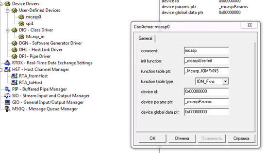

    Are not resolved a part of functions which I declared mainly in a configuration file aco_mod.tcf. These are functions of initialization of drivers of devices. For example, here a screenshot of a window of program Configuration Tool :

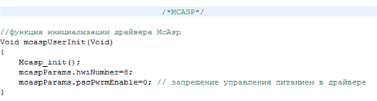

      Here properties of the driver mcasp0 are shown. Initialization function is  mcaspUserInit. Here function is defined:
    This part map a file which causes in me bewilderment:
    It is created two symbols _mcaspUserInit which is not defined, and _mcaspUserInit __ Fv which, on the contrary, is defined. Why it has been created two symbols? What means addition of suffix Fv to a function name?

  • Do you have C++ source files in your project? If so, please see this wiki article and the recommendation on declaring functions with extern "C" when mixing C++ code with C code or BIOS:
    http://processors.wiki.ti.com/index.php/Overview_of_C%2B%2B_Support_in_TI_Compilers#Name_Mangling
    You can also take a look at the "bigtime" BIOS 5 example included with CCS as it uses C++.
  • Yes, I use C ++ source codes. Thanks for the recommended documents. I will attentively study them.
  • Thanks for the help. The reason was in Name Mangling. I am completely satisfied by the answer.
