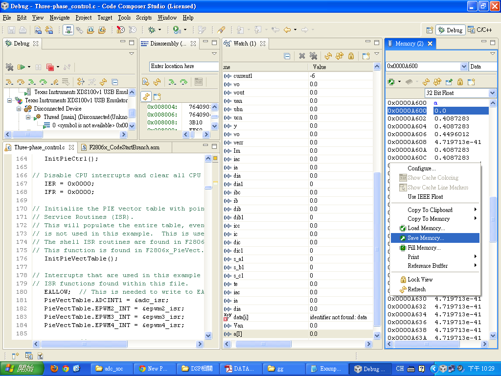

I write an array to save some data in my program,
interrupt void adc_isr(void)
int i=0
float data[666]=0.0
Voltage1 = (AdcResult.ADCRESULT1-1730);
Van = 70.71*(Voltage1)/1730;
if(i<=666)
i++;
else
i=700;
data[i]=Van;
first, is the program right??
second, I want to save memory to use those data to draw waveforms in EXCEL, matlab or something else.
and...
finally I get a 0kb file, that means I saved nothing!
I want to ask that which step I do is wrong??
please somebody help me ~
