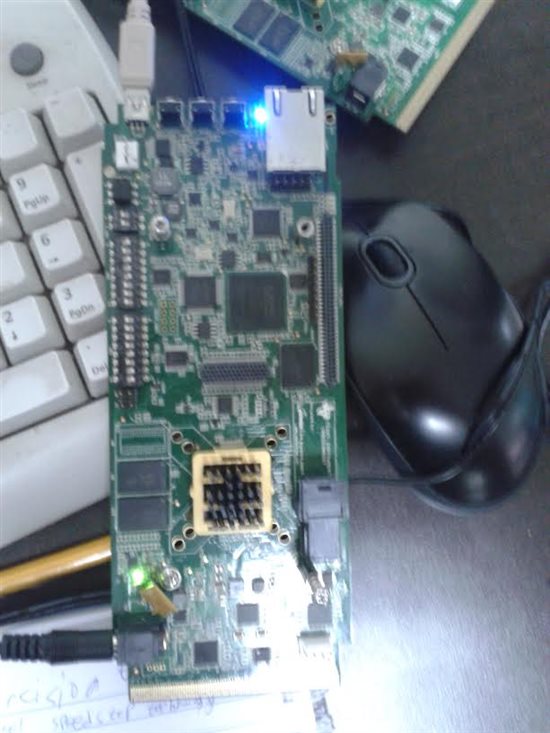

  • I am working with the TMS320C6657
    I can’t connect my board to JTAG .
    Debug LED's are off.
    Only D17 (yellow), D2 (blue) are on D1 blinks (red ) on startup.3
